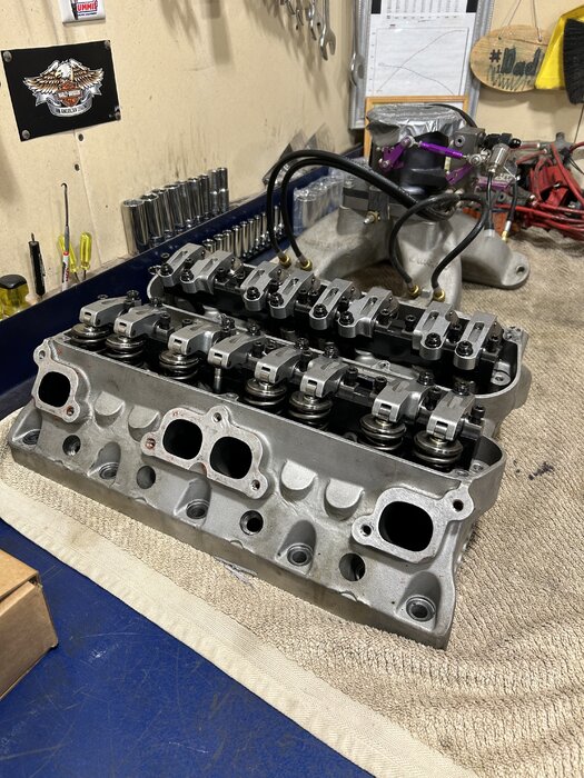

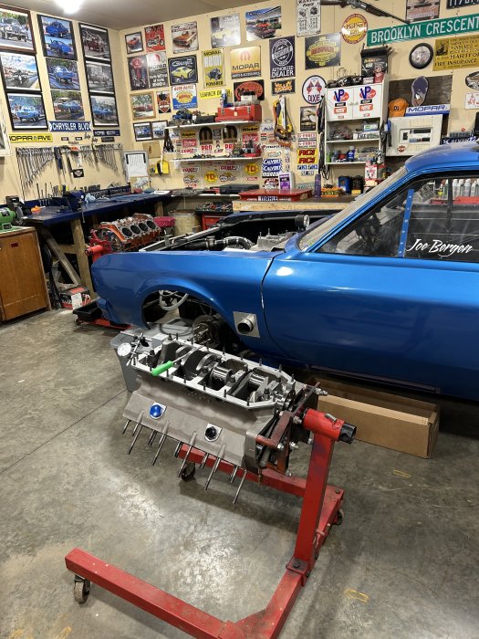

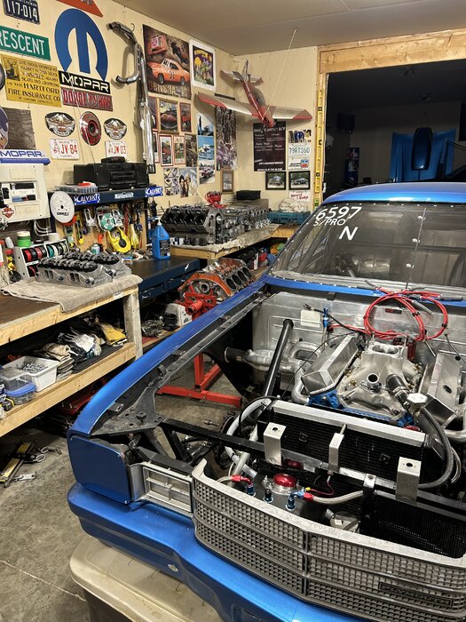

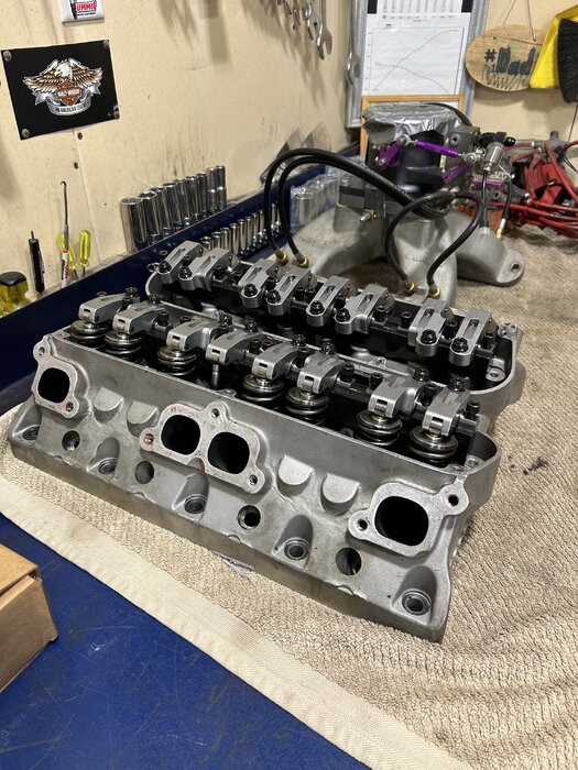

When will it end!! Lol I’m gonna be a busy man the next few months. 3 engines in my garage all getting worked on.
The 355” W2 in my car won’t take long. I pulled the intake to check the cam and lifters. All is good. Half a day and that’s done.

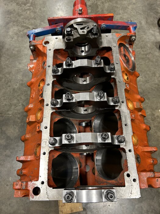

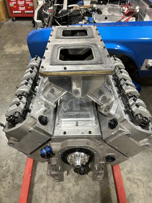

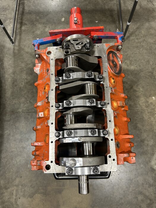

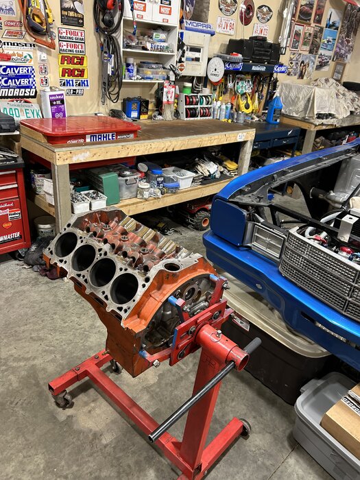

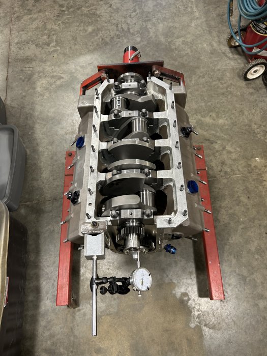

My aluminum W8 engine is in pieces for a bit. Waiting on the crank from the machine shop. Hopefully in a few months. Once I get the crank back I can start assembly.

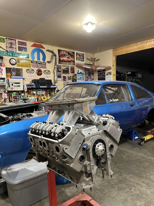

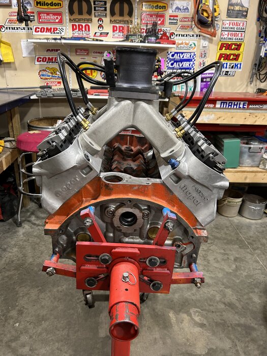

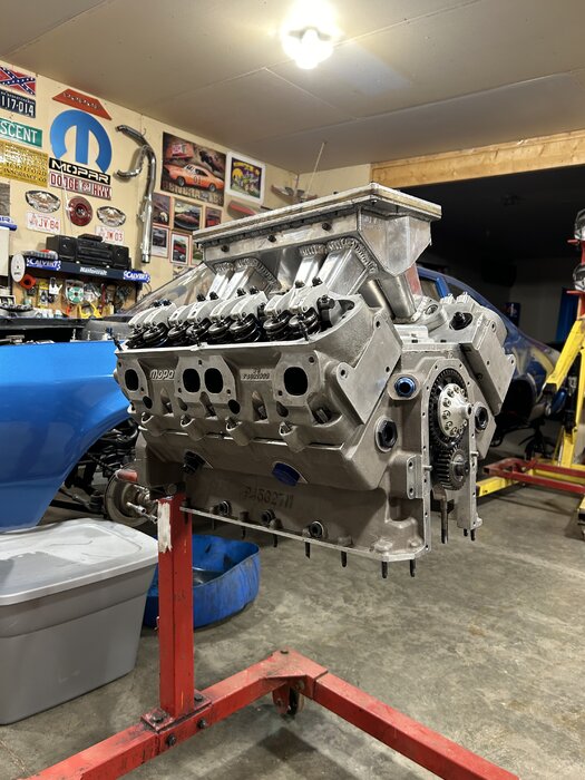

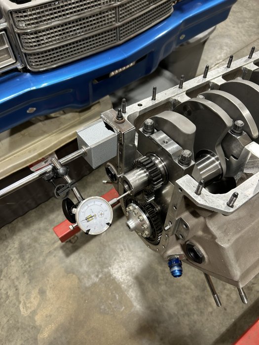

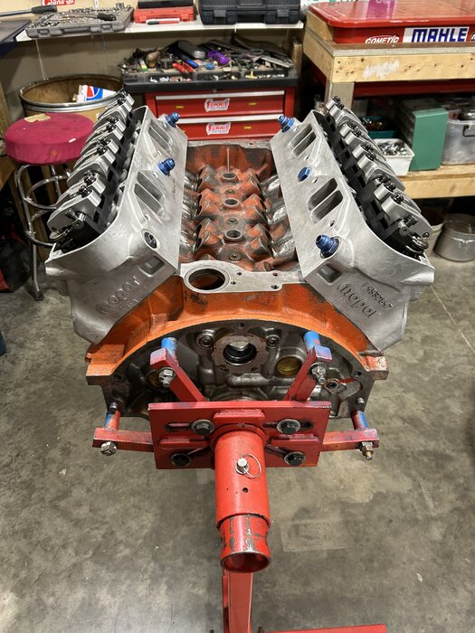

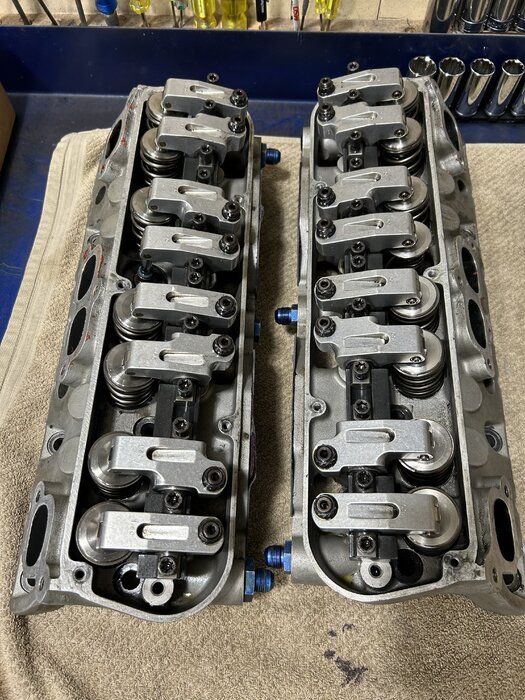

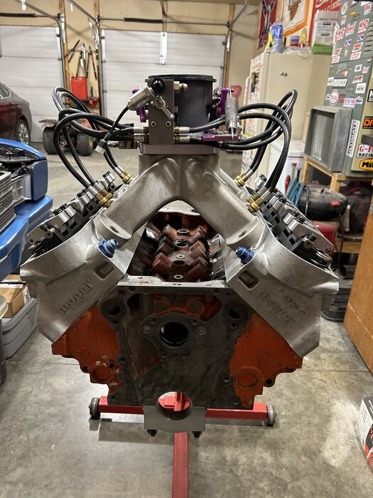

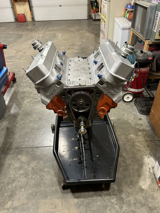

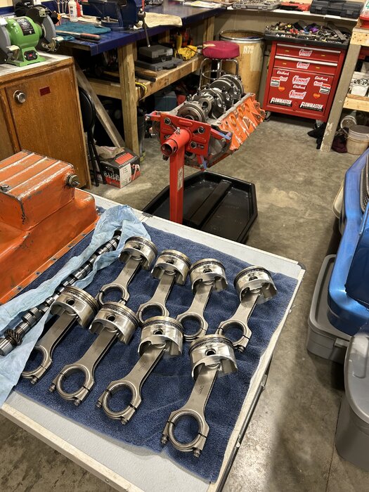

The R3 W9 shown in the pictures is a buddy’s engine. I have all the parts to assemble. Clean everything and put together.
Once that’s done, I’ll run it on the run stand to make sure it doesn’t have any leaks. If it’s all good, dyno session will be booked.
There is over 2000 HP sitting in my garage. Good feeling to have.

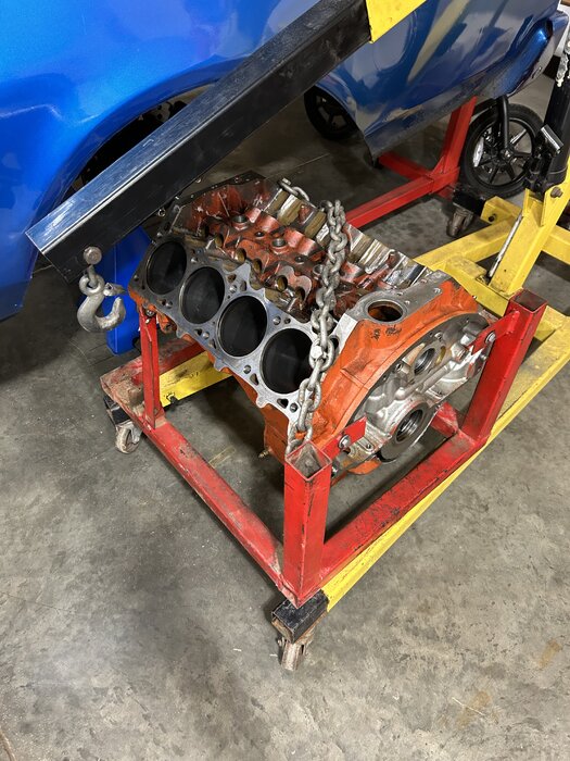

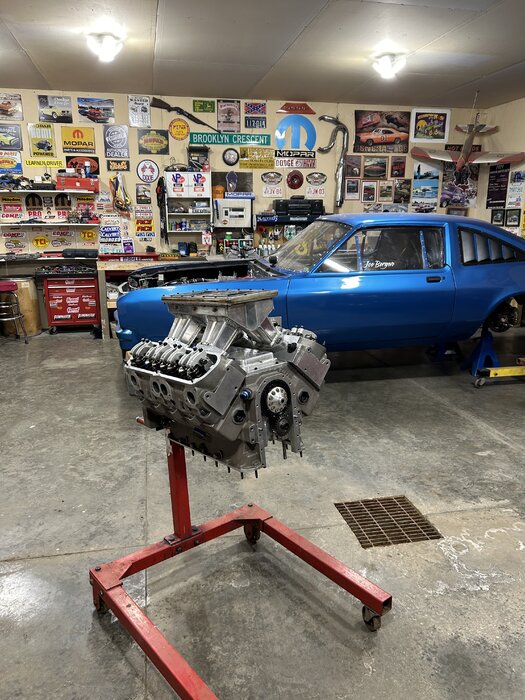

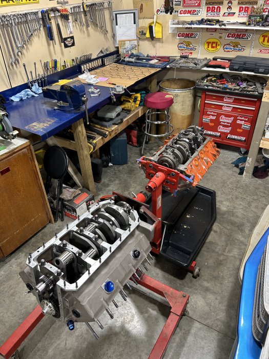

That short engine stand on the picker legs is genius. Talk about space saving!

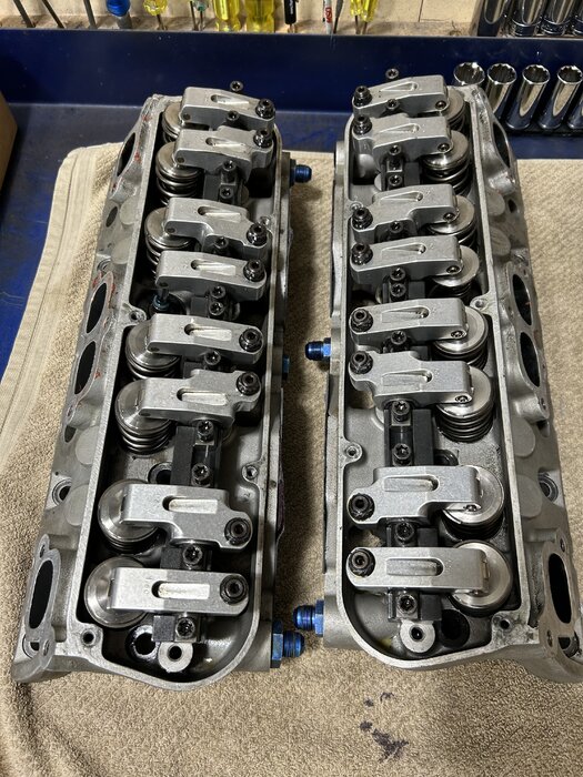

yes these W8 W9 headed small blocks are something else. my W2 is very mild compared to these engines. can't wait to hook up the W9 to the dyno. should make over 700. if i had extra money, i would like to dyno the W8, but i can't see that happening.
c'mon, spill the beans: so what are the specs here? (unless of course it's that "race secret" stuff, in which case I completely respect that)
btw: I genuinely am curious about the clearances you are running, assembly specs, etc.
I can’t really say the specs. It’s not my engine so I better not say. Lol I’m just putting it together for him.
When I put my W8 together I’ll share all the specs

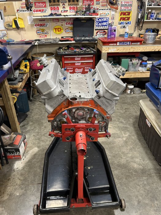

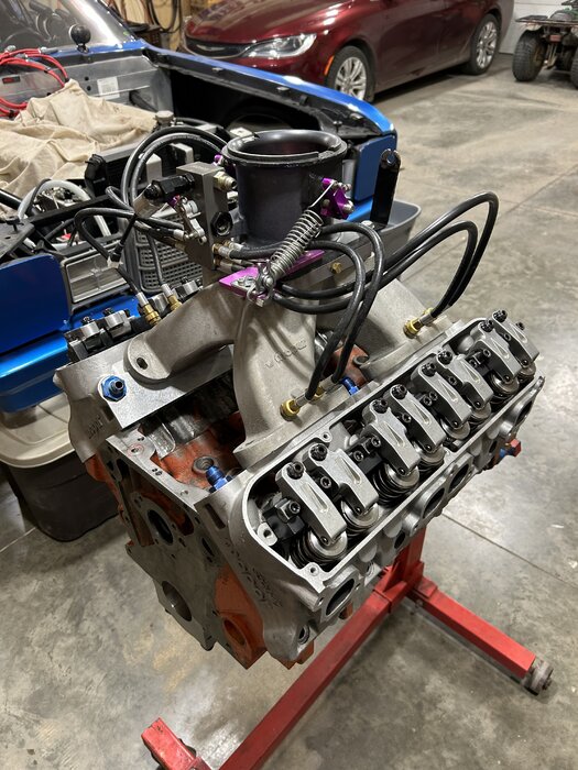

It was a bit busy in the garage today. Working on both engines since I’ve had no time for a while.
All the parts are here for both engines. Only thing stopping me now is finding time to assemble.
