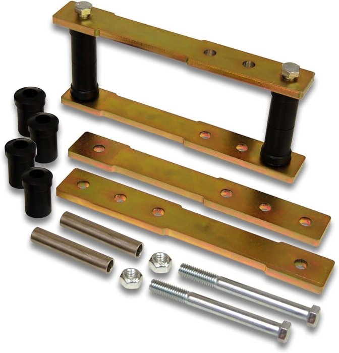

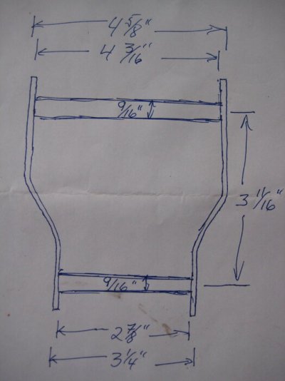

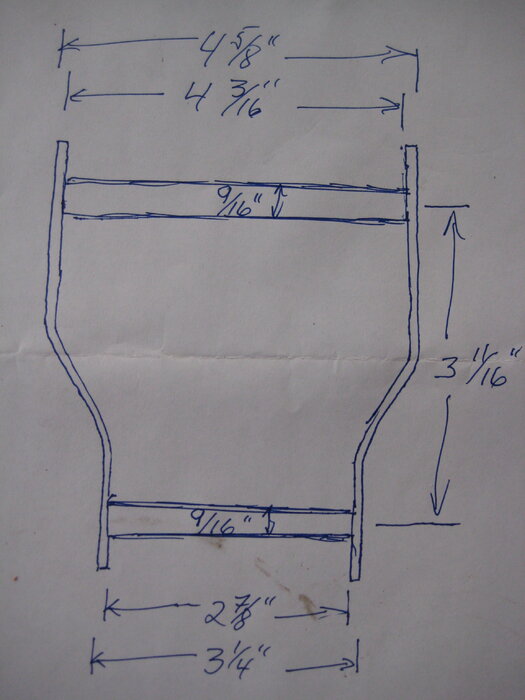

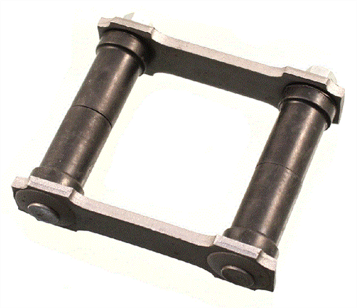

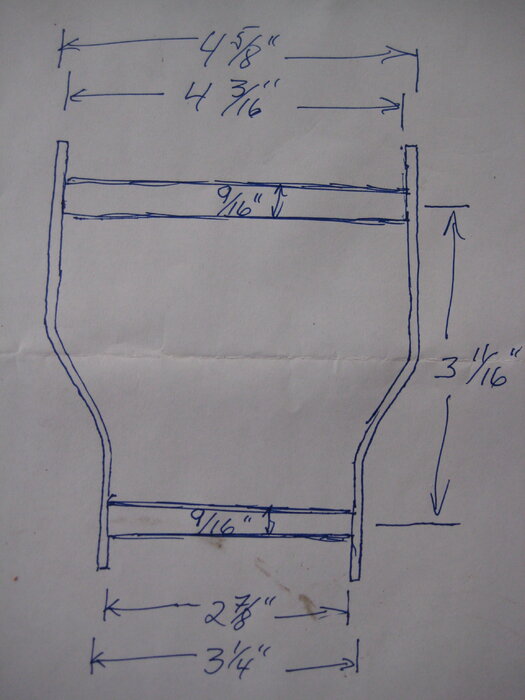

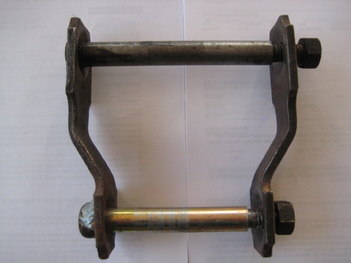

Maybe someone could bend up an adjustable set?
@Fresh Air Inspector did the measurements on his set
AMC Diplomat
Feb 14, 2023
1,640
773
NY

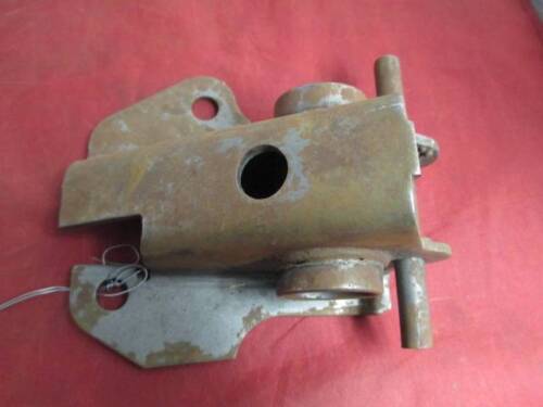

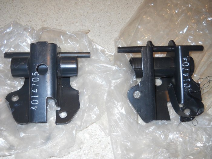

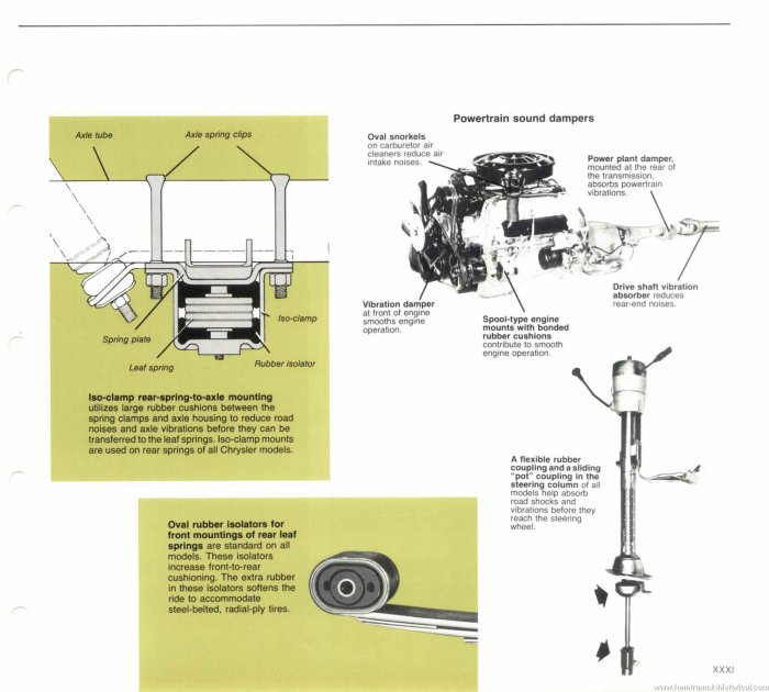

Think the ISO takes a massive amount of snap and bump out of the suspension and road feel inside the car. I think it may also have to do with lowering the rear end ride hight to prevent a lever action that can bottom out the suspension when hitting rolling bumps that, throw the rear up the car up and would allow it to crash down heavily otherwise.

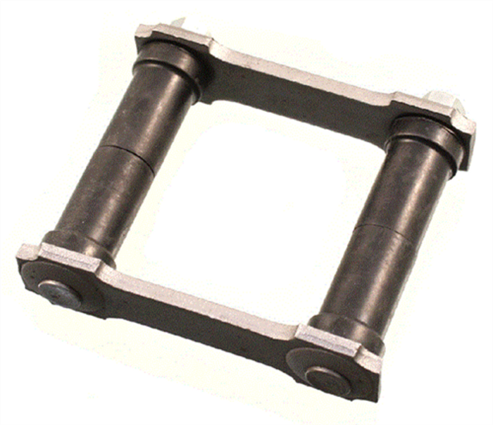

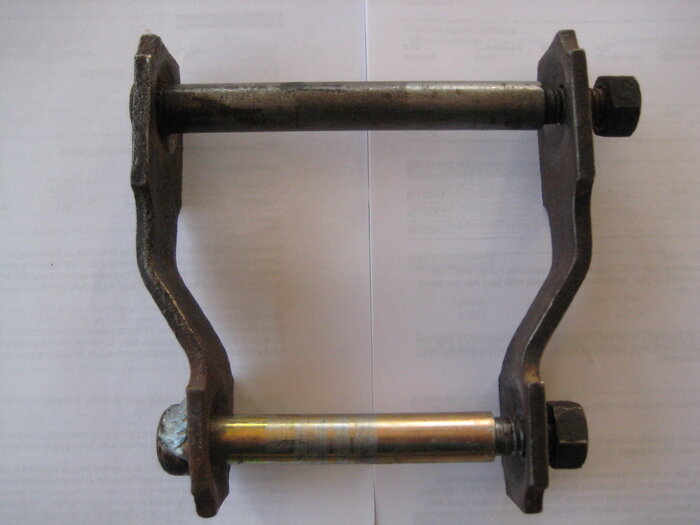

Are the AHB shackles just cold bent factory shackles to improve geometry or are they also thicker? Could probably make a jig or buy one of those Machete benders to modify a standard sets.
I'm also curious if the slight diagonal of the leaf springs, where the fronts are closer together than the rears, has something to do with the ISO setup

From The 1970 Hamtramck Registry Home Page
"To reduce road noises and axle vibrations before they can be transferred to the leaf springs." Similar to what it says about the front bushings.
That makes sense. After deleting the rear ISO and putting aluminum mounts up front, my car definitely felt more like a stripped down Honda Civic with stiff suspension that’s riding a few inches off the road. Feel absolutely everything; but the improvements in handling at modern speeds make it well worth it overall, for me anyway. All those rubber bits are what give the cars the gentle, soft pitch and roll boat ride that everyone loves so much.
I’d bet FirmFeels big front sway bar and rear sway bar would make the factory ISO suspension feel just right.

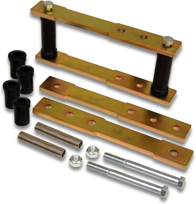

Would make sense about the added length
Cutting a few pieces of 3/16" or 1/4" flat stock seems to be easier than sourcing those. Or just buy the kit from FF.

It's ALL in the shock selection. You don't need to be riding on a rubber biscuit. The rubber ISO setup is just going to introduce more deflection as the axle tries to roll forward on the springs. I speak with firsthand experience with this. You can solid mount everything sans the springs and have a better ride with high quality shocks than the factory setup.

Any particular reason to justify the trouble over using the non-fleet model shackles considering their ease of availability?
Meh. I can't think of much other than if you have an AHB car and can't find the regular hangers and are stuck using the AHB shackles.
There has to be an engineering reason why, but at this point it's probably esoteric. I'm switching over to them for my 8 1/4 swap but only because they came with the axle
