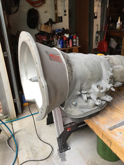

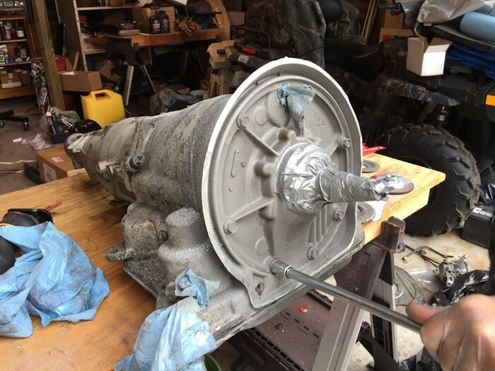

To give you an idea of what is involved:
No way in hell I would ever modify the block to make this work, so this is the way I decided to do it.
Got to say though, I don't think you're going to need a CRT built transmission for this project. I could probably find you a SB 727 to use behind your 360 until you go BB.

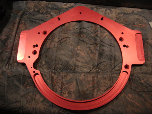

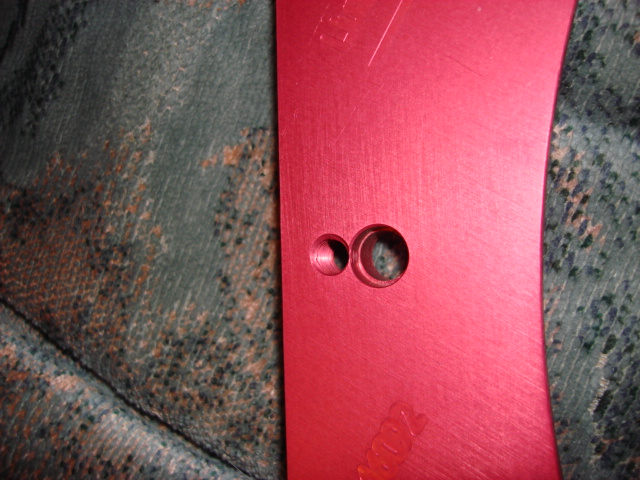

Here is a so called good adapter but its still just an adapter.
