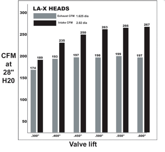

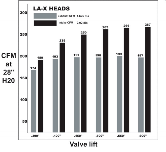

I am hoping to have 350-380 HP range, shit I would love 450 but thats just unrealistic with my set up.
Camshaft Type: Hydraulic Roller
Basic RPM Range: 1200 to 5700
Valve Lift Intake: .507
Valve Lift Exhaust: .533
Duration Intake: 274
Duration Exhaust: 278
Duration at 050 Intake: 221
Duration at 050 Exhaust: 225
Lobe Separation: 110
Intake Centerline: 108
This is all I can find, but I have stock size intake valve so flow will be down a bit. As you can see .550" is about where they stop I am .507, but then getting big lift at install heights of 1.64" is a problem, I have some after market Mopar Perfomance springs good for .600" lift so we should be safe. I can't remember now, take spring down to install height, then squash it down, measure that and take 10 thou off per turn on the spring, I think its something like that. Howards have said 110 - 130 on the seat and 320+ at max lift.

that cam is in my garage, problem I have is the springs are not up to it, I called up EQ heads and talked to a guy there and he said the springs they use are just a little better than stock and .500" lift was about the max he would want to go in lift with those springs, the 1.64" install height is a problem.
I have in my garage a pair of Indy X heads with PEP boys titanium coated valves just standard size with mopar performance springs and retainers, the install height came in at 1.58" and the seat pressure was 160lbs, so I had to get the spring bases machined for the 1.64" and now the seat pressure is 130lbs. Good for .600" lift.
Current cam is 209 @ 50thou but thats 262 advertised, the advertised for stock cam is 249/269 at .410/.417
