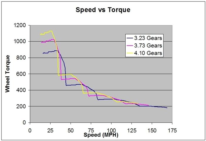

Found this in graph form, it's simulated but shows what is going on like AJ says.

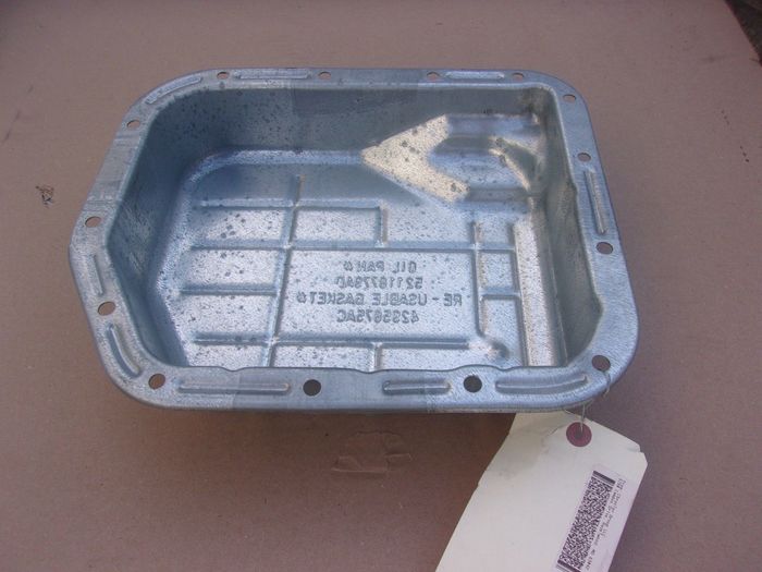

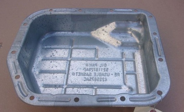

I have a deep pan dish on my trans, it took a lot of trans fluid, I mean lot, the thing is huge! So lots of oil to spread heat over!
Dodge and Jeep 4-speed overdrive transmissions (A904 versions: A500, 40RH, 42RH. 40RE, 42RE and 44RE, and A727 versions: 46RH, 46RE, 47RH and 47RE) have a deeper transmission pan because the valve bodies are thicker (more valves) and of added electronics inside.
I encourage anyone with an FMJ automatic transmission to increase transmission fluid (ie: deeper oil pan) and transmission cooler size for several reasons.
The 4-speed oil pans are fairly inexpensive (well . . . except for freight to get one down under).
Even Dorman is making new (deep) pans at a reasonable price ($21 (US) plus freight on rockauto.com), part number 265-839 (A904/A999 4-speed version).
Someone else is making new (deep) pans for the A727 4-speed version for $22 (US) plus freight, also from rockauto.com.
Either version can be obtained with a drain plug – but for a lot more $.
A couple pieces of advice on using deep oil pans: Try to keep the filter on lower portion of oil pan – if at all possible. In the case of the 4-speed pans, this will require a spacer and longer filter bolts, that looks like this:

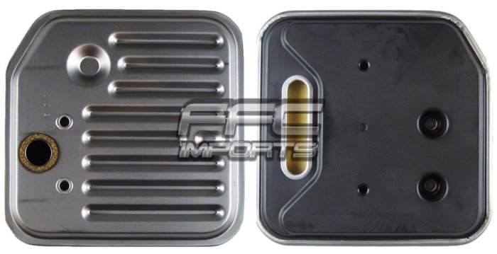

The transmission filter to use is one that looks like this:

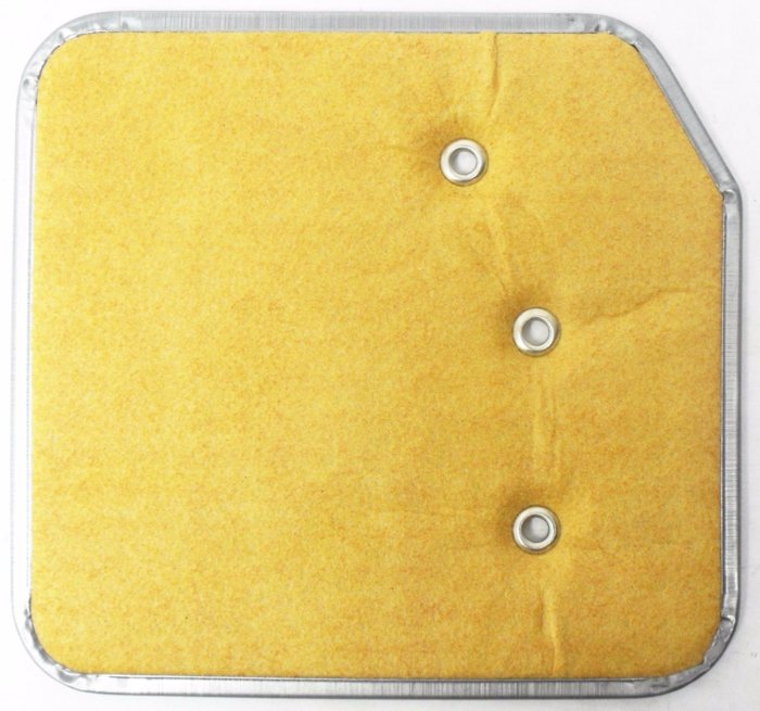

This style doesn’t fit (for the newer transmissions) and causes problems (unless you are using a 4-speed).

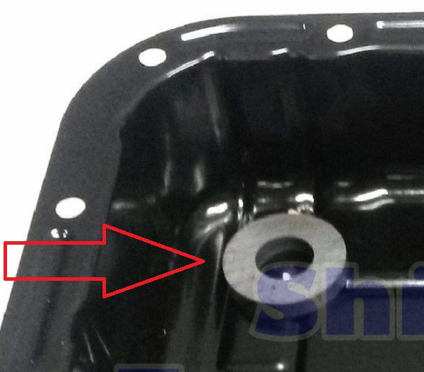

The magnet that fits in the transmission pans is also recommended – but not required. It does stop a lot of metal from floating around inside of the transmission

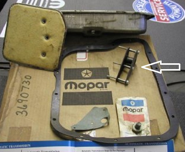

This is a picture of an old Mopar Performance deep pan (for a A727) from 20-30 years ago. This had a flimsy steel pedestal (white arrow) that went between the filter and the valve body.
I looked and couldn’t find any pictures of one in place. When you are installing the filter, the screws (longer screws, in this case) are going through the filter, the extension and into the valve body. The above picture also has a gasket that goes between the pedestal and the valve body.
It helps to have the filter at lower section/portion of the oil pan – which is what the filter extension is doing.
Think of it this way, you have a glass of a favorite beverage (some random picture I found on internet, below), would you rather use a straw that ends at the black line or ends at the white line? Note: for illustration purposes – mentally, YOU ARE using a straw – just in case you don’t, normally).

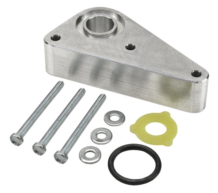

whats the lowering block called so I can find it on ebay or its part number
Dodge/Mopar Performance only sold the pedestal/extension/block as part of the deep pan set, so I don’t have a part number.
Go to eBay and perform a search using “727” and “filter” and scroll down quite a bit, and you will find several for sale. The material it is made of is not important.
A person could make yourself, one out of wood, if one so wanted to . . . (I wouldn’t, though).

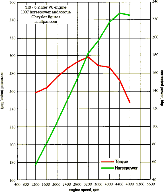

So below is a teener graph. Notice at 1600 it is making~ 265ftlbs/WOT,with a 2bbl. I don't think it's much of a stretch to suggest that at 1/2 throttle it might be making 140.
Now for me the clincher is this; With the line-loc set, I can just modulate the gas and clutch still well below 2000rpm, break traction, let the clutch out all the way, and then bring the rpm waaaaaay down to hear the BFGs howl. I've never actually looked at the tach, cuz usually we all are splitting our sides with laughter that this is even possible. If I had to guess, it would be well under 1600, with the throttle barely open. It's hard to imagine my 367 would have much more than 140ftlbs,lol.
