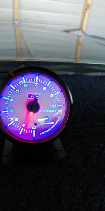

This is my idle from my howards 209/217 cam
The buzzing sound is the Holley electric fuel pump, so noisy!
This is a photo of the tach - looks about 700rpm

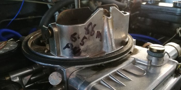

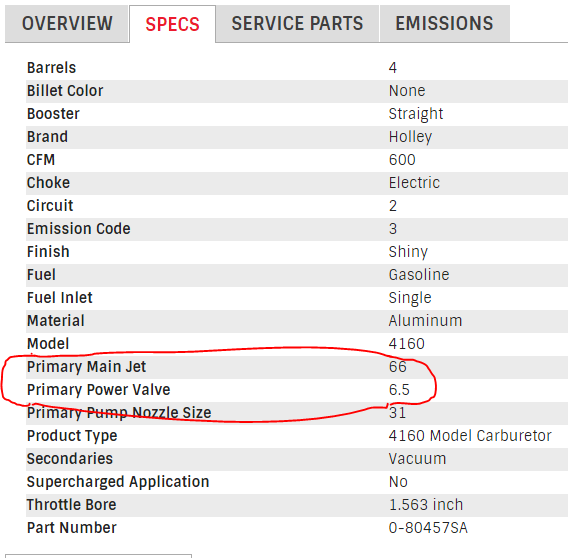

and this is what the carb tuner wrote for jet sizes on carb
this would suggest its got stock jets and PV

so with the standard setup in my carb (I thought he had changed jets but looks like he hasn't) been a long time since it was done, but I do remember him saying he noted on carb how it was setup. Would you expect a stock setup carb to run 10.6 afr, if not a suspect my AFR gauge is not reading correctly
3,133
799
How long does it read that, is it for a short blip or is it over a several hundred rpm spread? The reason I ask is that the power valve opening will cause an over rich moment.

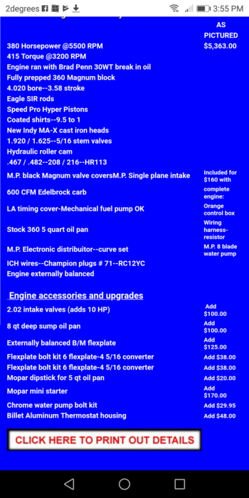

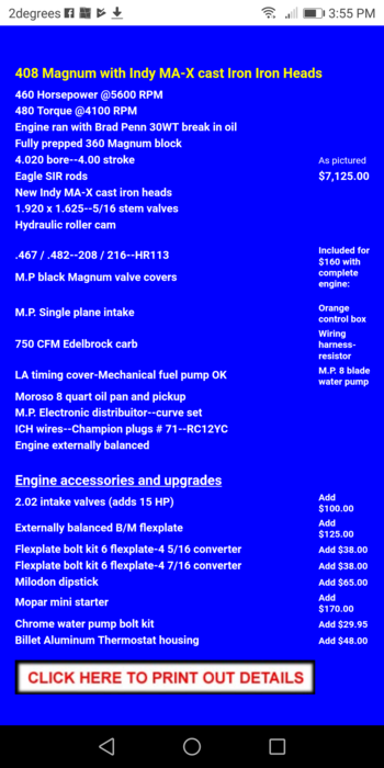

I've been looking around a bit and the 408 builds I've seen are good for 480 - 500 hp not even trying hard.
I think it would be real hard leveing power on the table, I mean the reason you build a stroker in the first place is more power.

I dunno where I wrote it now but what I have is indy x heads, stock size valves, stock heads, setup for .600" lift with MP springs and retainers, air gap and 770 street avenger, I have a 2200 stall in there at the moment behind the 360 so that may jump up a little with 408 so all that is left is the cam choice, my trans is a built 904 and rear end is 3.23 open but do have a LSD unit to go in. Mag block is only good for 500hp??? my trans is built to 450hp and a 8.25" with LSD only good for about 450hp
BTW - our fuel is rubbish here, its about as good as your 87 in the USA, we can get 98RON but RON is crap rating compared to MON. SCR is only good for about 9.3:1 but I do know talking with AJ Forms that choosing the right cam can bleed DCR down to work.
My setup will be SCR 9.8:1
I don't have 2.02 valves, I don't have alloy eddy heads, I have iron heads that are a bit better than stock.
I am going to build the 408!! just slowed down a bit at the moment.
3,133
799
Indys website doesn't make any sense, 80hp between the two motors and the only difference is the carburetor?

one is a 360 the other a 408, same cam, different carb, but that cam spec is what I have in my current 360 209/217 @ 50 with EQ heads and I tell you they are pretty much the same head! I am lost, my car is not a 380HP monster lol lol
