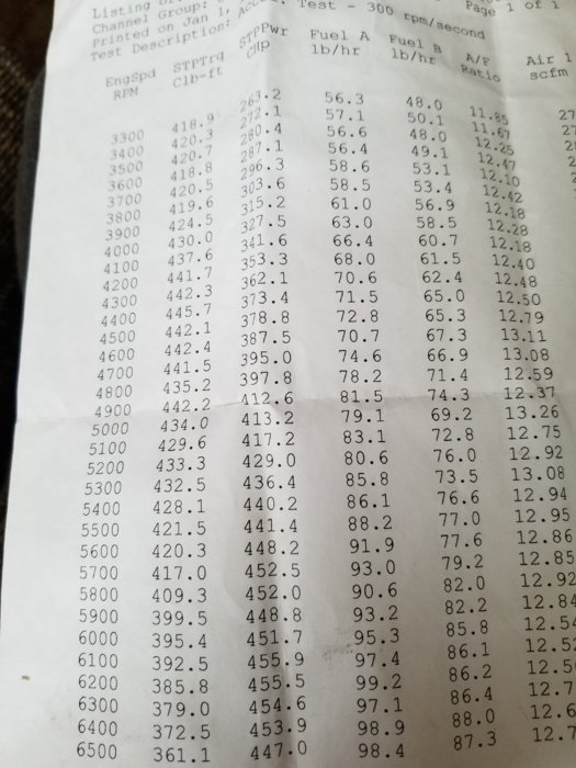

    I will find all my dyno sheets and post but here is taste. It makes 400 ftlb at 2800 this motor is na but was built 20180109_122441.jpg 20180109_122431.jpg for boost, 8 to 10 pounds and e-85. One pull is a 600 dp Holley and the other a 750 Demond.

    You have to note how FLAT the torque is, it's 2800 to 5800 400ftlb.
    This car is 3000 LBS, 3.73 gear with a 2800 rpm converter = fun.

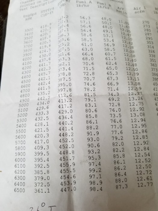

    I had three carbs on this on the dyno, the last one was a 850 race carb from my Mopars and the little Ford made the same power as the 750. We determine the intake was the restriction, an Edelbrock air gap twoplane witch supported all that torque was holding back horsepower.

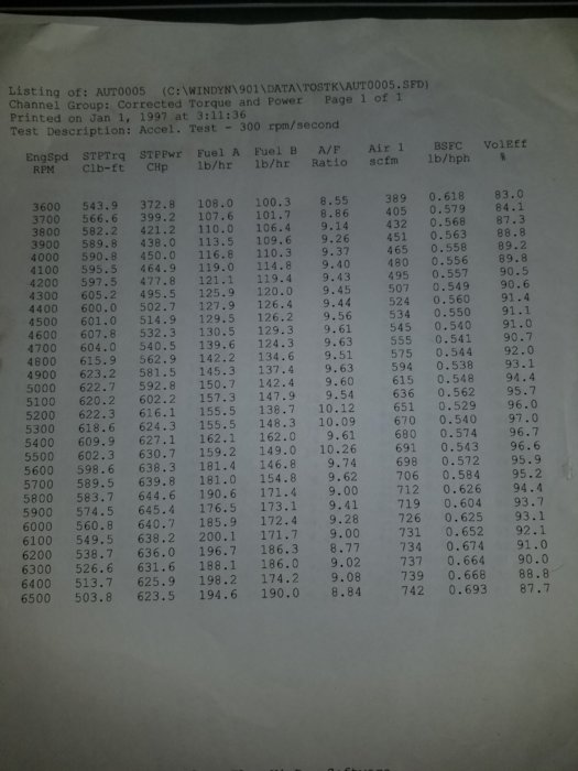

    500cid
    12.5 cr
    915 heads!
    E-85
    This 440 was built in 1992 by a great friend of mine, in 91 Mopar had offered a 4.15 crank, it took a year to get. I used 600 gram Ross pistons and a set of stock rods that had been bushed and polished. As shakey as that sounds it was good for 7200rpm. This motor has been updated three times over the years it now has H beem rods, the smallest cam it's ever had in it and a 950 cfm e-85 carb. The heads are as far as I can take them, I know you can't make power stock heads.......

    They don't have the correct date, motor ran 3/8/16

    One thing we did was back to back e-85 and race gas pulls, e-85 numbers were about 20 higher in torque and hp.
