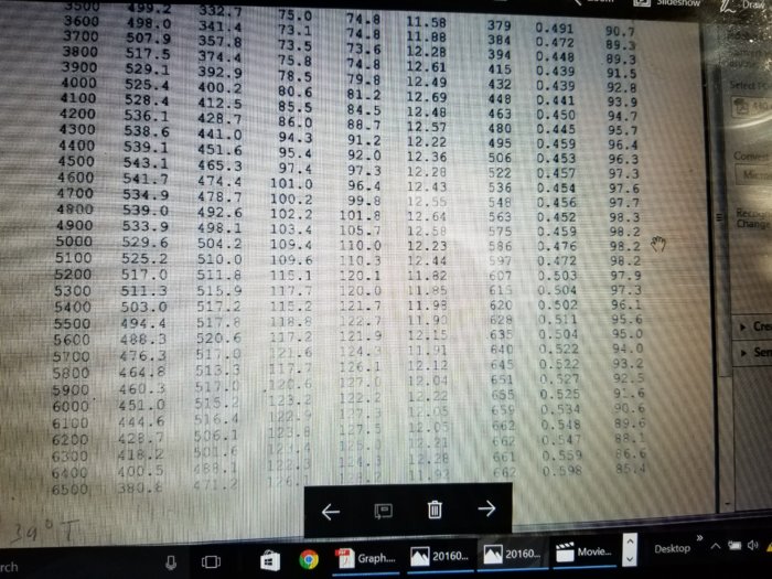

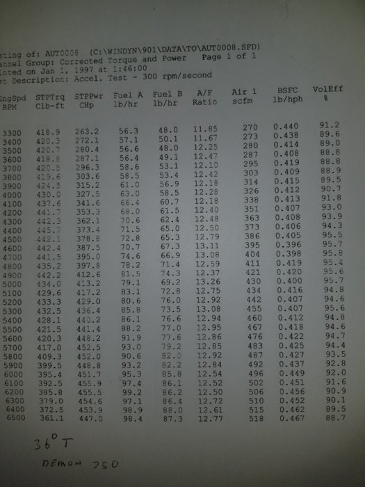

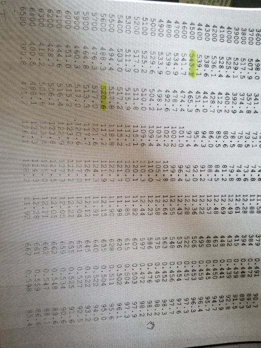

AJ I'm still looking for my dyno sheets for the 452 , I know what the peaks were but i would like to show you the curves of a larger cam with 9.5 to 1 cr motor.
452, I think the one on the top is easiest to make out.

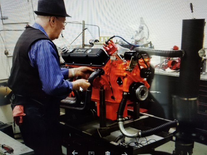

This is the man that can find hp, Stacy.
He is the guy sets up the dyno and does the pulls, he is an exsprintcar racer. One year he got sponsored by Mopar and ran B motors! He's the man that got me going on e-85. His partner Joe is a good friend of mine, these guys build mostly performance engines. There's a new chassis dyno in the back of there shop.
The name of the shop is Grawmondbecks in Mason City Ia.
641 423 8726
Grawmondbecks Competition Engines
I've known them for 30 years!

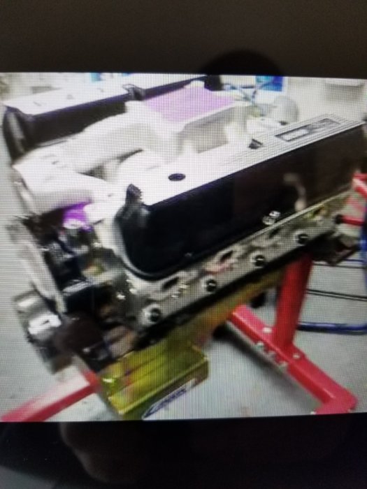

That's my 452 he's working on.

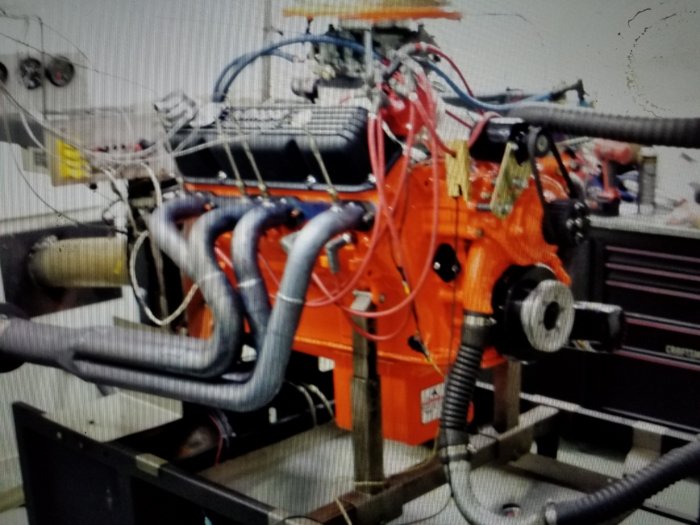

This 440 was first built in 88, TRWs and a basic blue print 9.5 cr to run on pump gas. I did the port work on the heads and it has 2.14/1.81 Manley valves, Mopar mech rockers, Comp springs and shafts and a Mopar p4120661 cam I had on the shelf. 257@050 duration with 5.57 lift, Comp recommended a cam with ten degrees less duration, but if you have a cam on the shelf.........
This motor has had the 590 cam in it and has OVER 400 7000 rpm pass's on it.

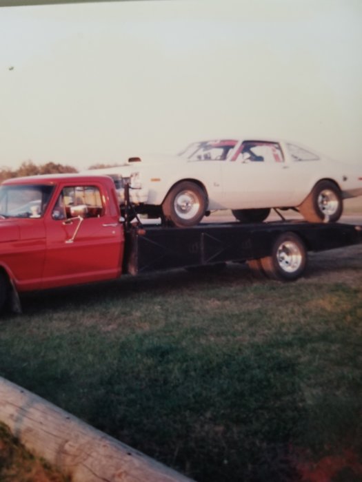

I have the converter and gear to make it run 11.50s in my Volare.
That's a pretty impressive powerband, Nice work.
In my 100% street 367, I once ran a 292/508, which IIRC was 251@.050, With Eddie heads and 11.2 Scr. That combo made all it's power from about 5000 to 7000. That was a chitload of fun, but with 3.55s, and a manual trans, I thought that wasn't one of my better ideas; the bottom was IMO too soft, and 5000 didn't come until 43mph, sooooo I yanked it outta there.
To me, a 557*@.050 and a 452 cuber, with over 500hp, lol, is .......... like what do I put it into?, and what am I gonna do with it? It's way too much for this old cowboy. The one I have is already almost too much. Well it is,but I learned to live with it,lol.
Unless I stumbled into another Mopar that's a 4 speed and needs a motor this is my plan B for Volare. There is room for improvement the first thing is new light weight pistons, id like to bring the cr up to 13 to 1, I already have a set of bushed rods

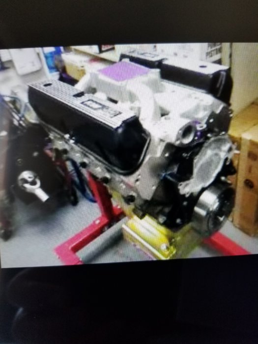

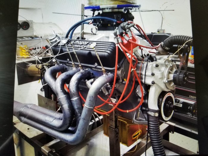

Here's my 500 on the dyno, the only thing that keeps me from having two complete motors is the valve covers and the distributor.
Note the passenger side water pump so I can use a stock F body rad..

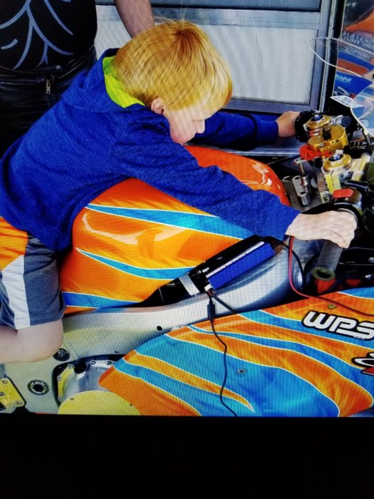

That's what he was running that day, he had hurt is good motor witch ran at 200 mph.
It seems fast for a bike on street tires and no wheelie bar! I don't know.
