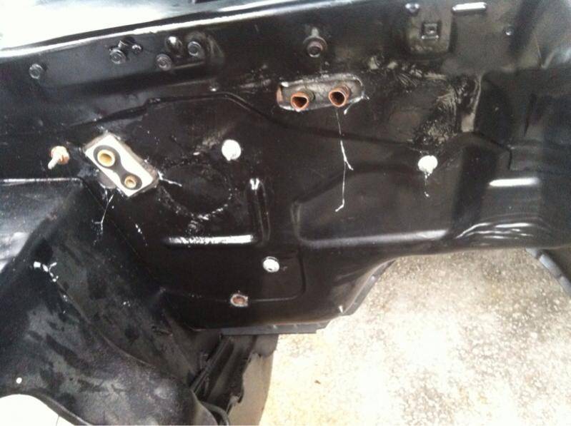

The grinding, truck bedliner, rubber coating of the INSIDE of the doors is complete.

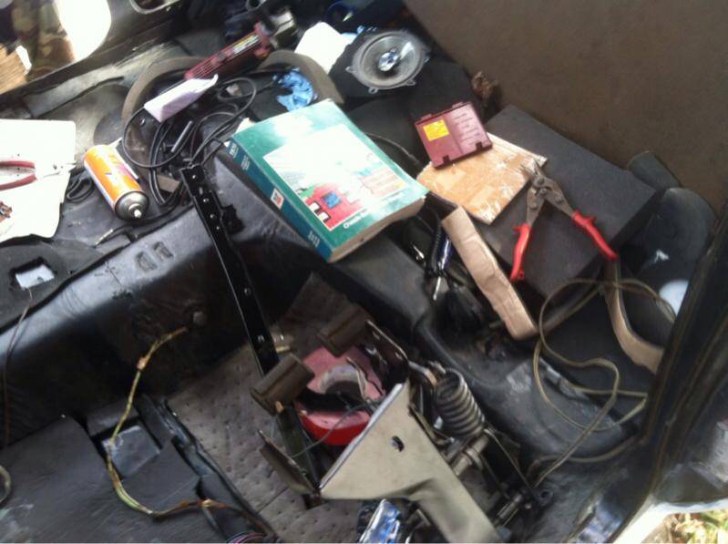

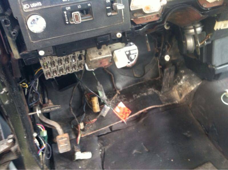

You have to use head liner glue (ours was in an orange can-pics to come). I have 3 large separate strips of rubber sheet now glued to the over head of the cabin.
I have about 3 pounds of rubber mat & 1.5 quarts of contact cement stuck to the floor pan inside the cabin. The sheets that soak up oil (pig mat is the unofficial name that I know them by) {these don't absorb water hardly at all} are on top of a few rubber sheet spots where the glue got away from me.
