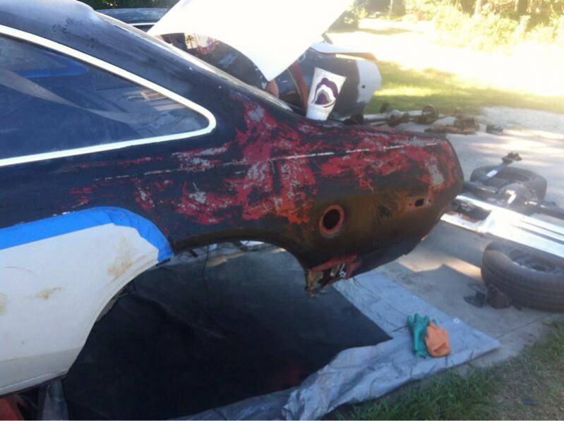

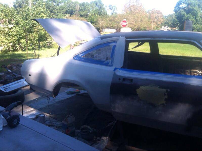

I'm up again after staying awake last night untill 3AM stripping the passenger fender that was encapsulated in BONDO...I also dug out my garage again...once greymouser takes away the scrap metal and the unneeded parts. I will be able to roll cars in and out of the garage again...we are very close to getting the cars done but allot has to happen every day for it to happen before my soon to be EX wife gets home..

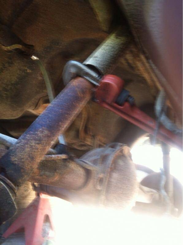

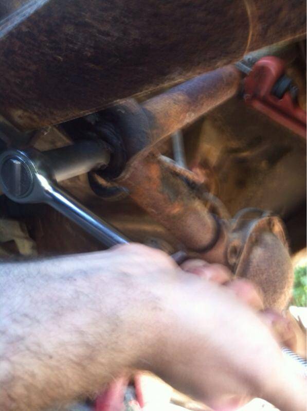

I am using a pipe wrench on the lower portion of the shock while I loosen the lower nut

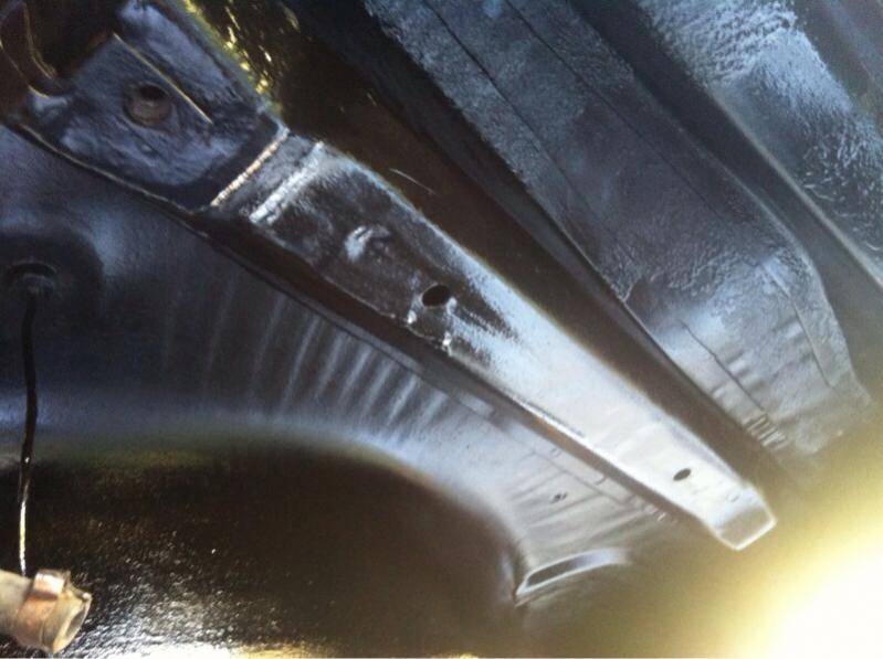

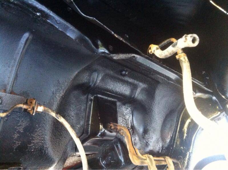

We applied truck bedliner over 99% of the underside of the rear of the car after I took the wire wheel grinder and wire grinding drill bit to every square inch under the vehicle. Rubber coat spray will go on after. I sure hope this holds the rust at bay considering we get so much rain and I drive on the coast where the humidity (intense) in the air has an alkaline (salty) PH which rusts the cars out very fast here. Everyone that parks at work has fading clear coat on their vehicles paint (if older that a year or two...).

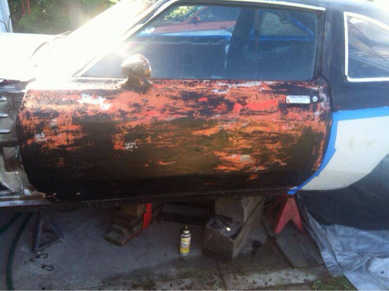

The pictures keep failing to upload when I up load from Topify. This door has two different coats of orange paint, brown & gray bondo layers (same as the fenders that I was bitching about, and the hood-all from the Volare Road runner) and a metallic green layer of paint. I fear that we scrapped one of the rare metallic green volare road runners.

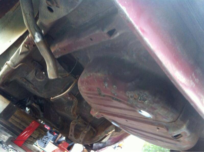

'Jim' sold me the trunk pan, filler neck, straps-everything needed to convert my early gas tank to the later 77'-89 gas tank. Just needed the fuel level piece which I found in my horde today. You can't slap the smile off my face because I am so damn excited. This car is going to be real sharp. ( thanks everyone for all of the help and encouragement!!!!!!!) these are the $20 gas tanks I found on eBay.
I do need to buy a filler-neck--gas tank grommet-rubber piece.

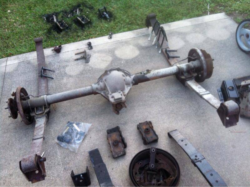

...the Volare Road Runner's 8 1/4 rear axle:
The axle came from a E-58 360/727 vehicle.
The gears are 2.94, which coupled with a .73 over drive, will ensure lots of affordable driving.

Rich was so happy to try out the electric sander that I brought
- a hand held black and decker electric piece, coupled with 60 grit 3M sandpaper melts excess bondo away.
Measured the leaf springs...
-we had to get ?outside narrow? {basically lock washers} 1/2 inch washers to run up the zinc'd-grade-8-U bolts because we could not tighten the nuts all of the way. The backing plates had to be removed (axles had to come out..C-clamps) just to tighten up the outboard U-bolt nuts. The leaf spring isoclamp plates that I used are ribbed unlike that which I have used in my B-body. This setup required allot of wiggling during the assembly. Because they are ribbed, the fitment of the U bolt nut and narrow washers is real tight.

Did not do much today (my birthday) I ate some chocolate cake, and spent some time with the wife and baby. Rich and I did paint truck bed liner inside the trunk.
Rich ground thru most of the paint on the driver's side door it's mostly at the green paint level-am not sure where the bondo level was. Rich & I have a bet about a cd player for his car and he got one for $19.XX but also paid $13 for the installation kit at Walmart...Guess I owe him a buck.
