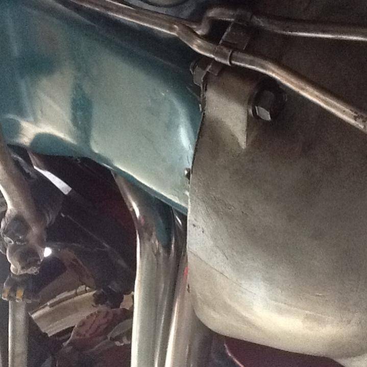

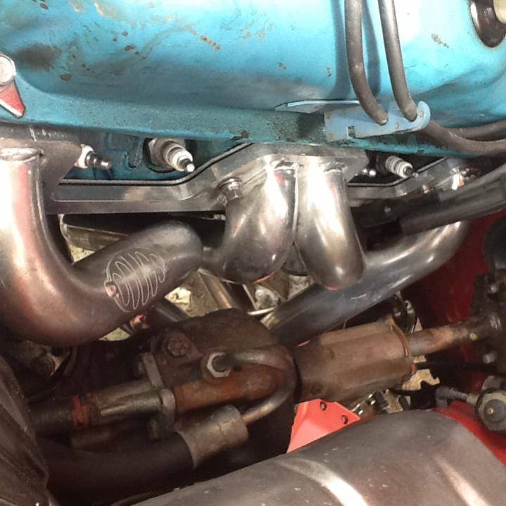

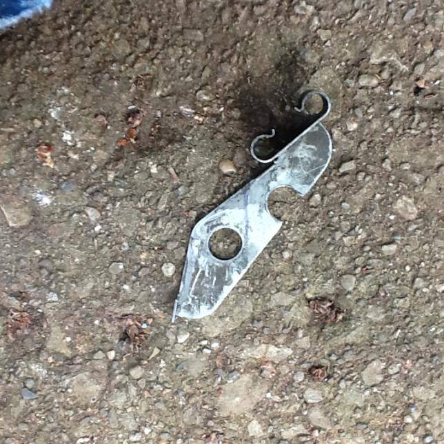

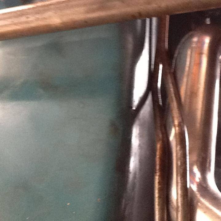

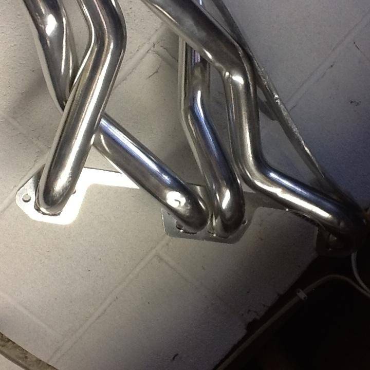

Headers are in. plenty of room. One issue though is that I had to slightly move the factory tranny lines for clearance. This involved bending the lines and modifying the bracket that holds them to the bell housing. Not a big deal, but for what these cost, I shouldn't have to do that. Another thing worth mentioning.... Looks to be plenty of room for the 904 and 727. I have to re-do the exhaust because it won't fit. Much easier spark plug access, and more clearance to the brake booster. You must use the mini mopar starter which I already had. Easy access to all the header bolts. I could get a socket or box end wrench on each one, didn't have to use the open end like my old headers. I will post pics tomorrow p.m. I think these are worth the money. They give me about 1.5-2" ground clearance over the old ones.

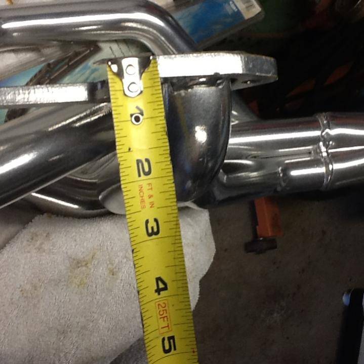

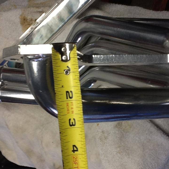

Could you measure from the center line of the ex ports to the bottom of the headers?
dougs headers
some pics and measurements. The distance from exhaust centerline to lowest part of header is 16"

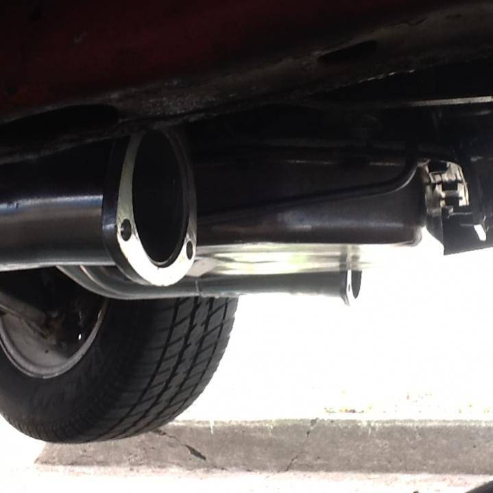

Some may remember when I started this thread, that I had tacked up a stainless y pipe for the exhaust. 2.5 into 3". I've been running an older used exhaust with turbos that dumped in front of the axle. That's all gone now and I had to cut up the y pipe again to fit with the new headers. I was going to use a tranverse muffler behind the gas tank, but have decided to run a single 3" flowmaster delta 50 muffler with 3" stainless tailpipe out the back. I have the tailpipe tacked together and will post pics soon and some video when its all installed.
Exhaust is in, but have to take it to a shop to weld the tailpipe to the muffler. Sounds Great, quieter inside. May be down on power though. I'm going to put a pressure gauge nipple in the y collector to check for excessive back pressure. If the pressure is good, I'll have to work on re-tuning the carb.
