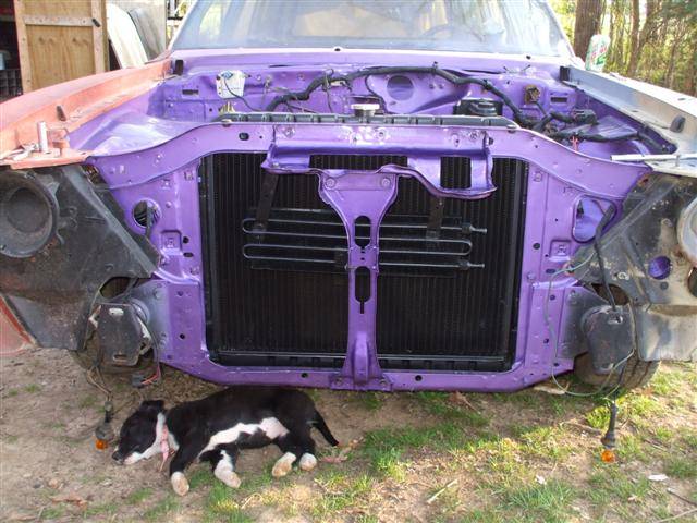

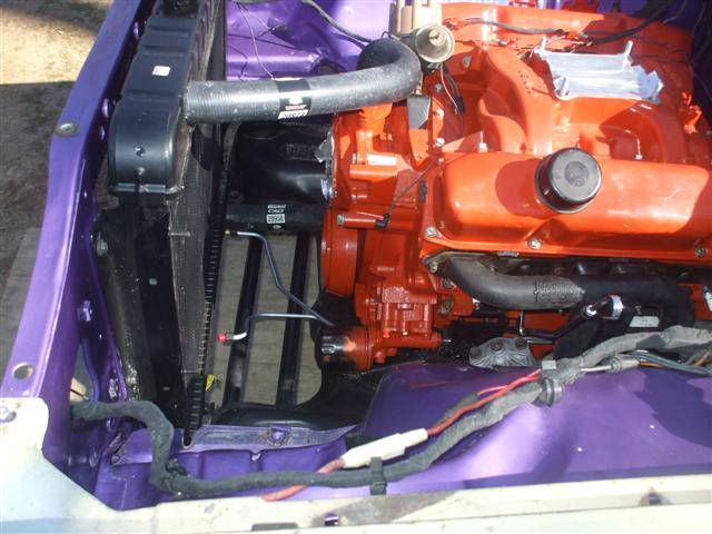

B body transmission cooler lines on and the wiring harness all wrapped up. Put the headlight relays in the same spot where the Diagnotic port was.
Still gotta clean up the factory aux trans cooler before I hook up the driver side line. Pass side hooked up in the right spot.

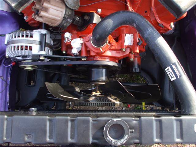

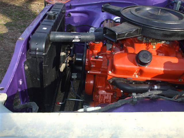

Got my pulley setup from 440 source. Really nice product for the money and it comes with a Gates belt. Also mocked the fan up to see the clearance. Now all I gotta get is a good shroud and my transmission cooler cleaned up

Nicely, nicely done.... I'm really encouraged by the clearances and the "factoy" look. I can see one in my Imperial now. Source a power brake booster and let me see that in there too, lol Keep the pics coming.

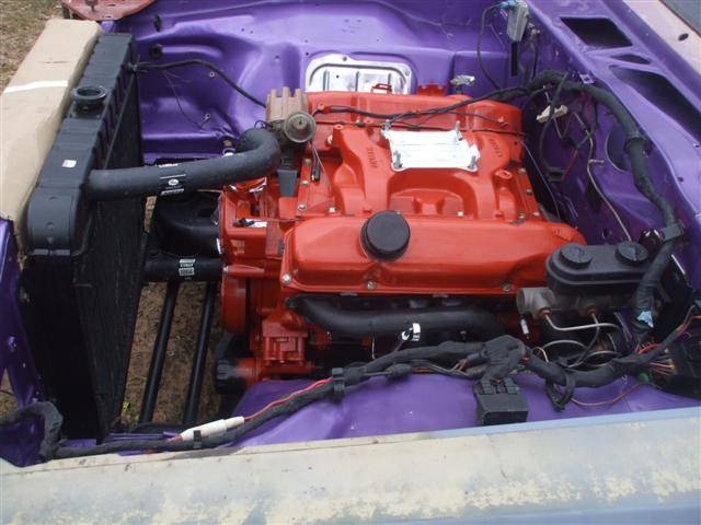

Trans cooler is cleaned up and ready. Just gotta hook the hoses up and clean the steel lines that go over the core support

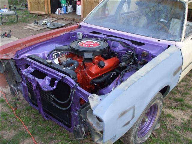

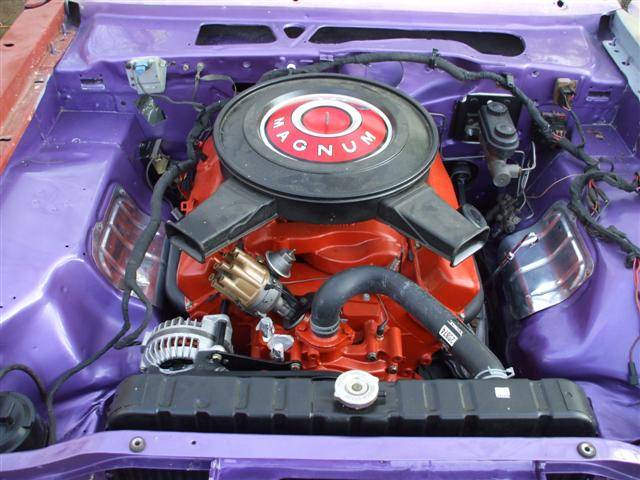

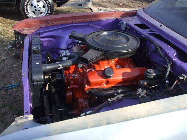

The 440 just looks right. Need to get the correct pie tin though

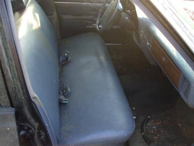

Im thinking of running the bench seat and vinyl floor out of this 89 Gran Fury police car
