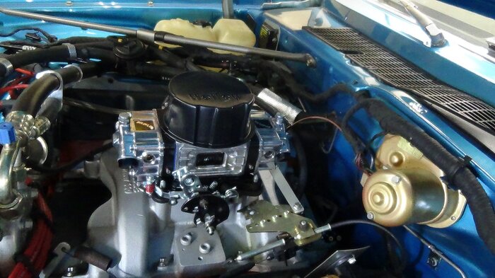

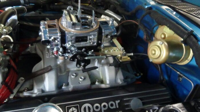

Got the throttle bracket modified to fit the new carb. Then found the bracket I had made that goes to the right rear carb stud to stablilize the throttle bracket didn't fit. The secondary pump arm hits it so,,,,,,,,,,,,,modified that piece also. At the same time I broke out the Eastwood gold cad kit I've had for eons (and all 3 cans are still good!) and used that. Previously, like in the photo, it was painted Detail Silver or Aluma-Blast or some such color. It obviously isn't real gold cad but as long as you don't look too close, it's a reasonable substitute. Same stuff that's on the wiper motor.

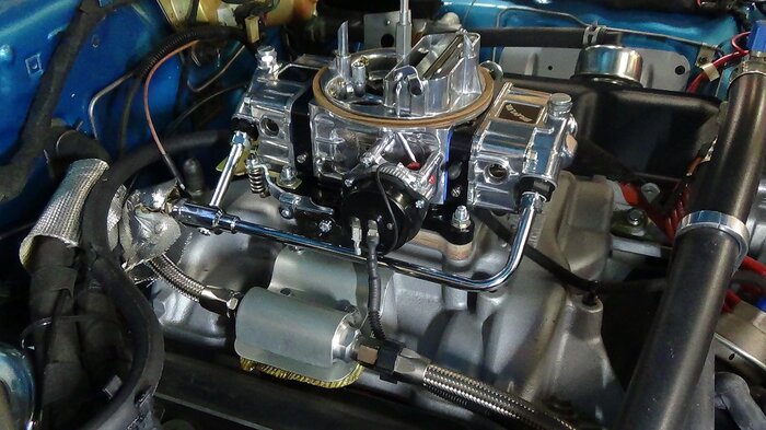

When I got the new fuel feed line, found that because on the new carb the fuel inlets are lower the fuel line hit the intake. Stacked a pair of 1/4" base gaskets as a check. Ordered a 1/2" phenolic spacer and waited,,,,,again. Carb bolted on and hooked up but then the air cleaner hit the hood. Pulled the 1/2" air cleaner spacer out and that solved the hood problem with about 1/4" clearance. Except the air filter base sits on top of the float adjusting screws and won't seat fully. Stacking 2 air horn gaskets was the ticket. Also had to make the fuel feed line another 3/4" longer to reach the inlet line. Made a new piece between the filter and carb. p.s. getting braided hose into the hose end without an assembly tool will test your patience, lol.
So,,,,,,,,at long last I fired it up this evening. The float levels are a bit high and I'll need to adjust the idle air screws yet BUT, first impression is HOLY you know what! INSTANT throttle response. Can't believe how quick the engine revs up. The old carb was never even close to the way this one is. When driving back into the garage, I hit the gas same as I always did before and the car just about leaped. Took me by surprise. Too beat to mess with it tonight anymore but already I'm thinking all the problems getting it actually on the engine so everything cleared, and the price tag, are going to be a fading memory real fast. Next step, after adjustments, shakedown run! Hopefully this weekend, weather permitting that is.

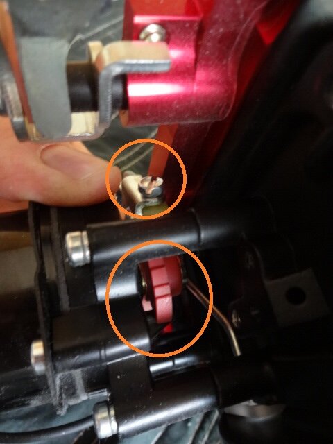

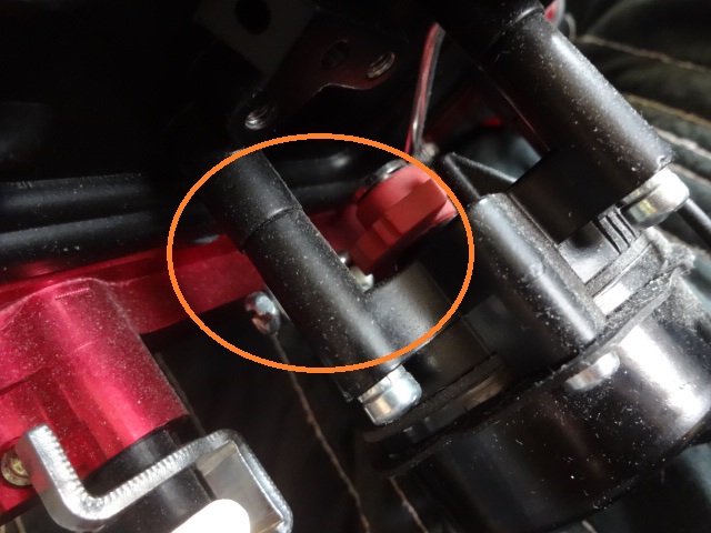

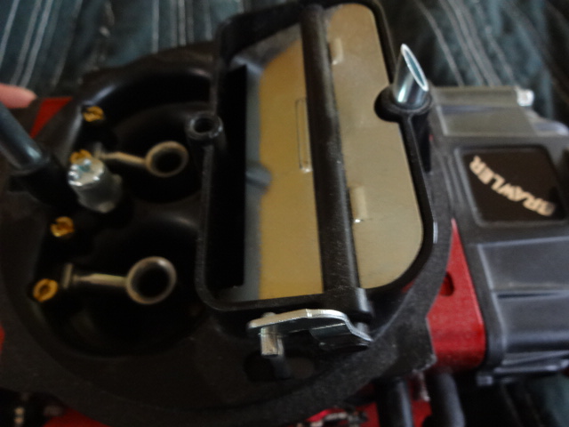

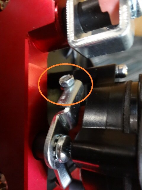

On your brawler from the box its set to fully close, behind your "lean" adjuster is the stepped initial setting and you can see the adjusting screw in these pics and the stepped adjustment.
Now im sure as it is when could one pump and the choke flap is fully shut, adjust accordingly. I adjust starting on the more open "lean" setting then you can get it right in one or two cold starts vs running rich, fouling plugs and only having one chance per cold start.

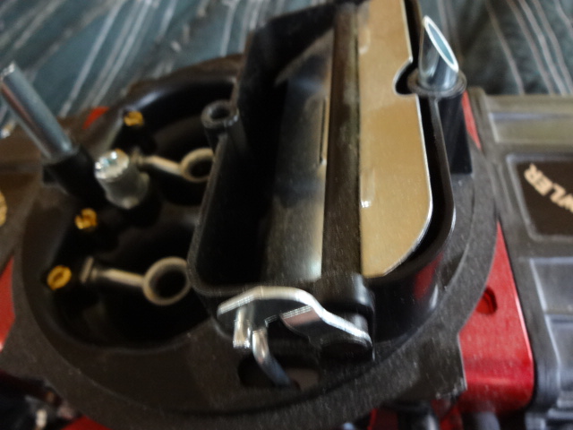

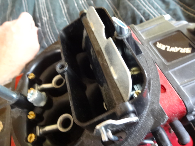

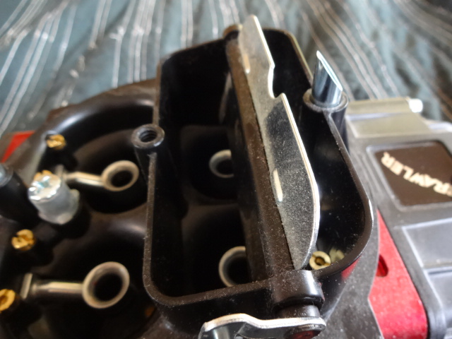

Here is the choke flap with it hitting the different initial settings depending on how you set that screw.
Here are some of the initial open pump set choke cold settings on the different steps.
Then fine tune with your outer adjustment.

Been awhile but I got the choke on the Brawler to work fairly good. A little cold blooded but it doesn't load up anymore and it's good enough for me, and the cars intended use.
