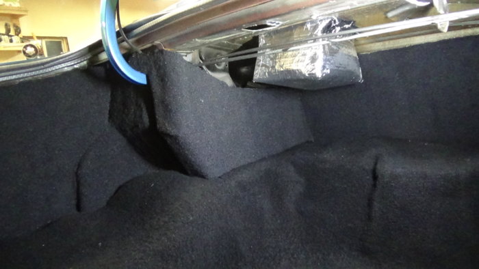

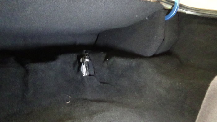

I've decided to ditch the plastic hinge covers and make new ones from panel board that go all the way to the rear seat. Those will support the sides of the under package tray panel (that I have to make yet) and also hold a carpet panel on the back of the rear seat area (when I make one).
Got a little farther this afternoon. Mostly it was looking, thinking, planning, etc...
Turns out I don't need to have any fastening method for the side panels. When they're installed, they aren't going anywhere. Got lucky and they fit tight, the upper edge is against the wiring channel. Still may put Velcro on the horizontal part where it meets the trunk floor though, just to be sure.
2,991

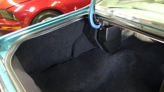

Other than screwing up the wedge cut where the carpet has to bend at the angle, the trunk side panels turned out decent. A little tweaking will fix the boo-boo. Just sitting in there and not secured yet but it's getting there. The under deck panel is next on the agenda. In theory, that should be fairly simple but, you know how theories are...........

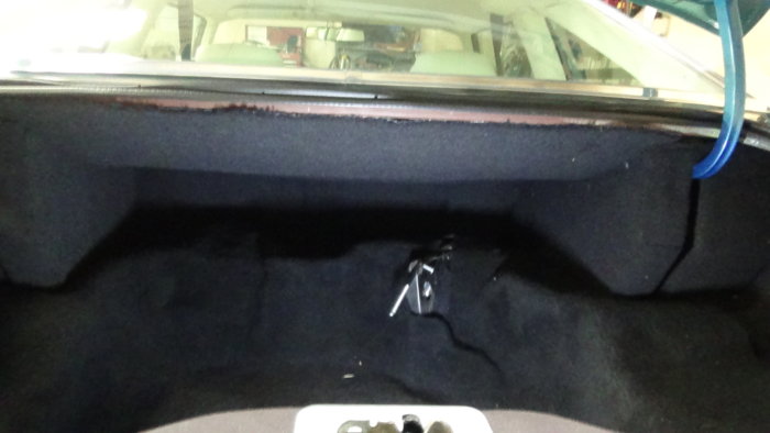

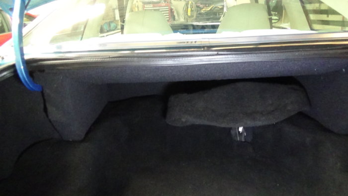

Another step more or less done, the panel under the rear deck.
Have to come up with some sort of trim where the carpet meets the weather seal channel yet. I've a couple ideas in my head and hoping one of them will be feasible to do.
Other than securing them all, mostly using Velcro probably, it's getting closer to finished. Velcro should help hold the floor carpet flat along the edges too, instead of all wavy. They all stay in place pretty well with just friction but still need something more.
On the agenda yet is finding a donut spare, which I have a carpet cover for. A full size won't fit (too wide). I've got a scissors jack from who knows what car, that is cleaned up and painted, along with a urethane pad attached to the contact point, to go in also. Probably never need a spare but, just in case......;)

Came up with a simple solution to cover the bare carpet edge and metal showing under the weather seal. Have most of a roll of fender welting left that I bought to mount the hood scoop. Trimmed half the "flap" off and then used 3M Trim Tape to attach it to the edge. Turned out fairly decent.
All that's left, aside from securing all the new panels better is, the underside of the deck lid. Not sure yet but, I think that's going to be the toughest part to do. That's a lie. I DO know it's going to be the toughest.:D
Before and after:

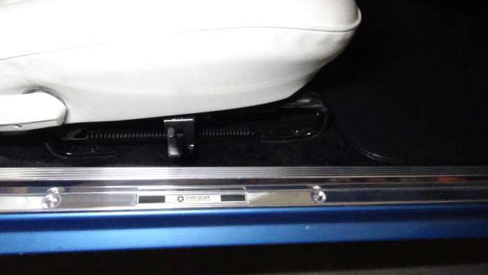

Since I had the car backed out earlier, made sure to park it farther from the wall so the right door can open all the way. Headed out there now to see about installing the seat track cover I got a couple three months ago, which requires unbolting the seat from the floor.
2,991

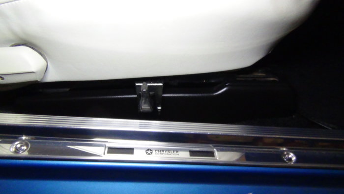

Got the right side seat track cover put on. Tried to get decent pics but it's like the light gets sucked up no matter where I put it. My old FujiFilm camera (with a flash) bit the dust after ONLY 18 years and the video camera has no light source. that's my story and I'm sticking to it:D
Dark before and after. Kind of film noir, ain't it? lol Doesn't help any that half my garage lights don't work or are really dim. They're on "the never ending to-do list".
