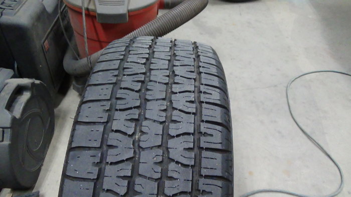

Aside from the brake problem, I obviously have an alignment problem. Guessing it's toed out excessively. Should be a clue since it hasn't been touched since doing the alignment and set the toe at 0 degrees and 15 minutes toe in. The tires are worn on the inner edges and are also chopped. That would indicate a toe out problem vs a camber problem. Camber would wear the inside edge but would wear evenly, not choppy. Something is going on and the brake pull may or may not be the brakes themselves. Going to take some digging, careful inspection and head scratching.
The more I think about it, the car does have a slight pull to the right when driving. Not a hard pull but the kind that would put you on the shoulder in a few hundred yards if you let go of the wheel. Another one of those things you get so used to, you don't notice it anymore.
Tires only have about 3,000 miles on them:

You need to move the front to the rear for a rambunctious weekend or two and make them round again. Fresh concrete will do it just fine.
1,492
As far as tire wear, I'll point you to this: https://www.forfmjbodiesonly.com/classicmopar/threads/alignment-problems.8446/

I won't know about the alignment thing probably until next year. Still thinking it's toed out too much. Would explain the twitchy feeling on curves, like it will follow one tire, then the other, so you have to keep correcting.

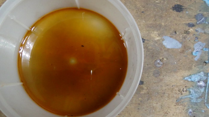

I should listen to those ASE test questions and follow my own (and your) advice, lol. Got a couple tiny air bubbles but the fluid, good God. Hey, it was only a theory about air in the system. Fluid in the reservoir looks fine, only a slight amber tinge. Fluid that came out of the left caliper looked more like old power steering fluid or something. Brown, rust colored, blech. I then checked the right side and while not clear, is only slightly amber colored just a hair darker than what's in the reservoir.

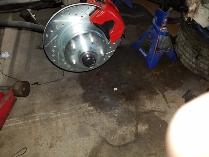

So, as many have mentioned, caliper could be sticking (even though the piston retracted fine and the brake doesn't drag more than normal) for some reason or it's the hose. The plan: Pull the left caliper and take it apart for inspection. Either replace or repair it, change the hose right away and be done with it, THEN change all the fluid front and rear. If it hasn't salted out yet by that time, take it down the road and see what happens.
