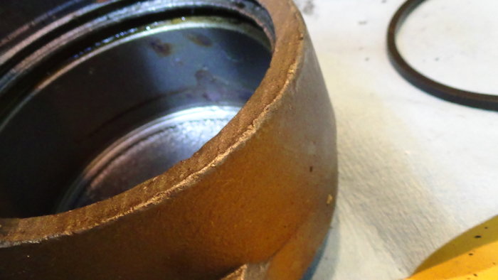

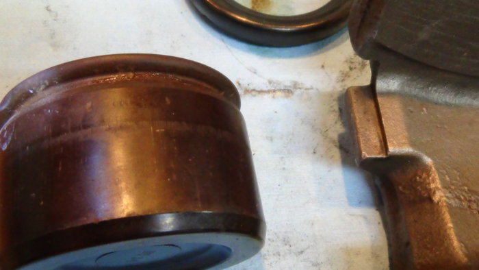

The saga continues. It's not the hose, I can blow air through it easily (by mouth and brake fluid tastes so good, not). Pulled the left caliper apart and found the piston is scored and there's some fairly bad rust in the bore. Since it isn't the hose, it almost has to be the caliper. The brake line to the hose is free and clear as well. I've decided to replace both calipers and change the fluid in the entire system and see where I'm at. May pull the rotors and haul them down to work and give them a light machining also, just to get a fresh surface to start with.
Hardest part is taking it all apart without scratching anything and without getting brake fluid on anything. So far so good. No scratches, no brake fluid.
Hard to see the rust in the photo. It's about impossible to take a picture of the inside of a caliper bore.

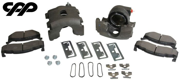

I think the Aspen will be good again, once the problem is taken care of. Going to stop at NAPA down in Mosinee where I work on the way home tomorrow and order a pair of calipers. Advance Auto is next door, in the same lot as the shop but I like the NAPA ones better. Advance is bare steel, the NAPA ones are coated which means,,,,,,,,,,,less work for me!

I'm hoping they're as advertised. You can only rebuild some things just so many times before the casting are just plain shot. They don't last forever. Everytime they get bead blasted and the bores cleaned up, it removes material. The copper washer sealing surface is one. The little "rings" vanish and you have leaks. The bore gets too big and the pistons rock, etc.
I don't need the pads hat are included but they didn't have them without. No biggie. They have 5 pairs available yet and wonder if that means when they're gone that's it or will more be made at some point?

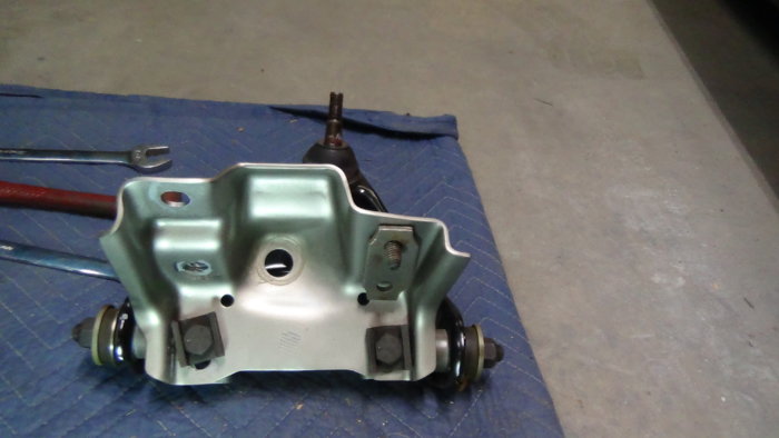

Since I seem to be getting lazy (which I'm working to turn around), and they added free shipping plus a 10% off code, I went ahead and just ordered the control arm bracket shims off Ebay. Still $75 for 4 pieces of steel with holes but the heck with it. Order them, bolt them in, done. Well, done until an alignment in spring,,,,,,,,,,,,,,,,,,whenever that comes. Hopefully before the end of June but I won't hold my breath.:mad:

Well, the control arm bracket shims came today in the mail. No calipers yet. No rush, because of the crap weather lately, won't be able to test the brakes out until maybe next May at the earliest. Stupid snow, stupid ice, STUPID salt and (much worse) liquid brine solution.:mad:

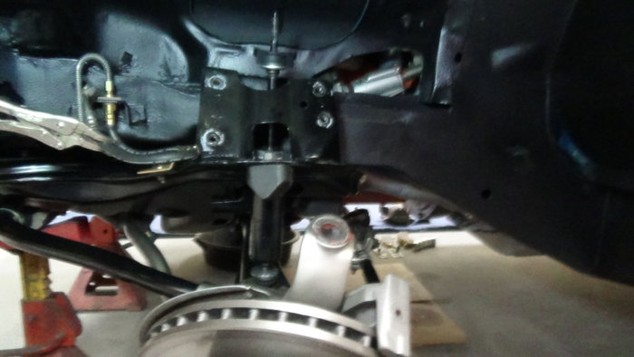

Put the control am shims in this afternoon. Beat the TSB flat-rape time of 1.8 hrs, lol. I'm not sure how it could be done without unhooking the ball joint and still get at the mounting bolts.o_O I suppose it could be done but sometimes, doing what seems like more work ends up saving you work in the end.
