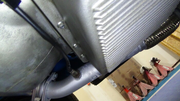

This is where I wanted to put the resonators, right behind the flex pipes and hangers:

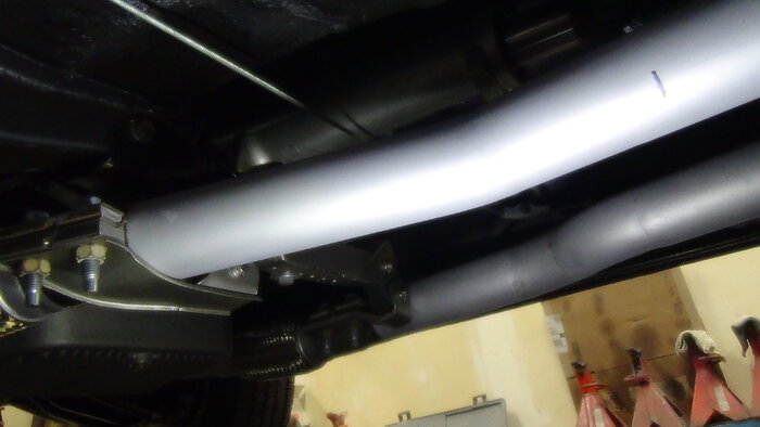

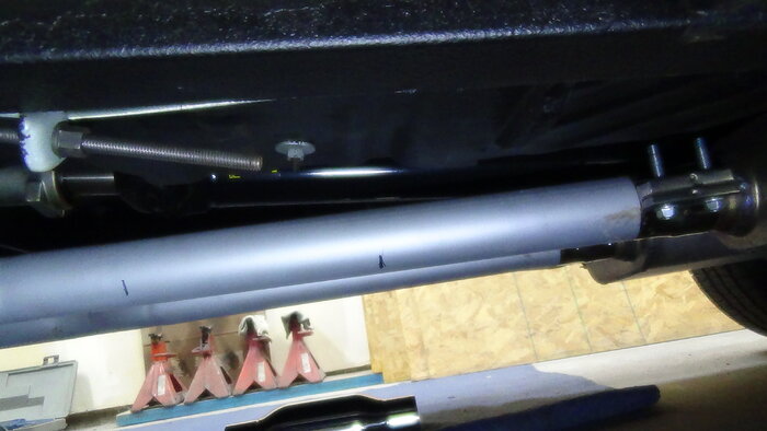

This is where they're going to end up going. Marks are about where the cuts will be:
