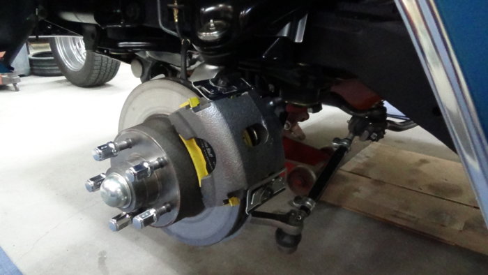

The new calipers came today. Have to mask the boots and give them a coat of clear (Eastwood Clear for bare metal) so they stay new looking, and then we're in business. It (the clear) held up good for 7 years on the old ones, except where the right one seeped fluid from the banjo bolt. No ridges for the copper washer to seal on anymore.
2,991
This morning, got the new calipers cleaned and clear coated. Bolted them on a this afternoon. I'm going to bring the pressure bleeder home from work to bleed the brakes, front AND rear, to get every drop of that old, nasty looking fluid out. Then I wait,,,,,,,,,,,,,,,,,,until spring when I can see if they're fixed or not, thanks to the salt job from a few days ago when it snowed.

I got the front brakes bled today. Only went to the end of the street and back but it seems to stop straight and stop excellent now.
Of course, I forgot to bring the pressure bleeder home so a certain redhead of the female persuasion did the pedal pumping.
The camber is slightly positive at the moment but with the shims in, the tape measure toe check shows it's darn close to zero instead of the 1/2" out it was before.
I'll worry about bleeding the rear brakes this winter to get the old, nasty fluid out.
