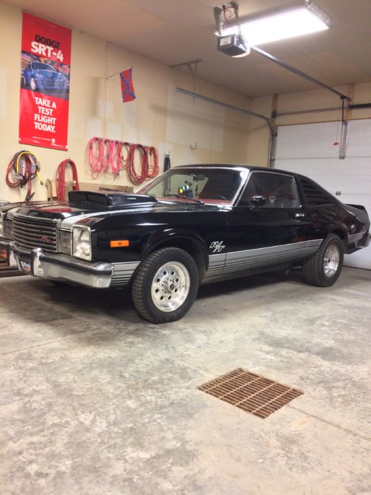

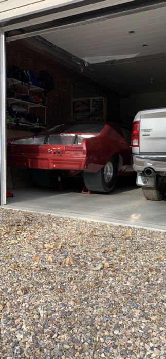

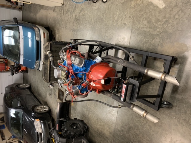

It’s that time of year that depression really sets in. The last picture tells the story!! Lol
Actually it’s not that bad. 2019 was a good year. I got my car running and made a few passes down the 1/4 mile. Can’t complain about that. It’s been 6 years since I have been down the track, felt really good to get out there.
Selling my black R/T was hard to do. Buying this Volare site unseen was a huge risk. In the end it turned out good.

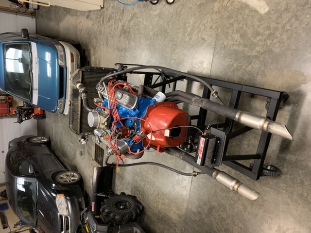

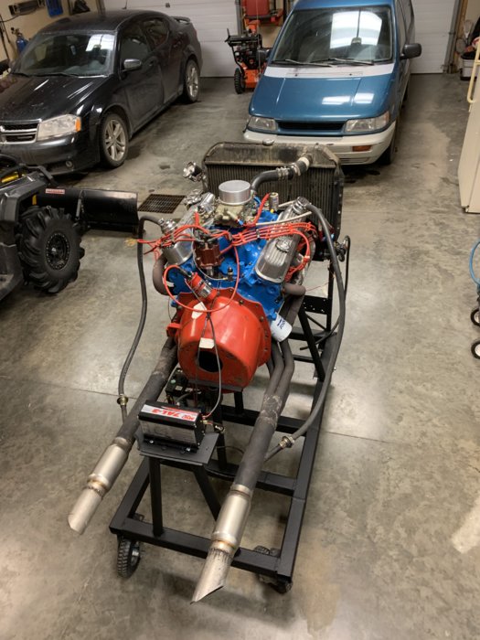

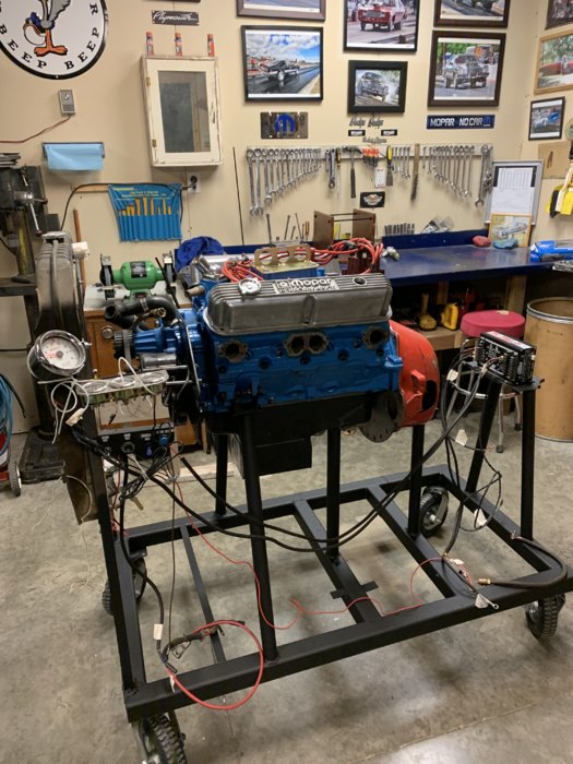

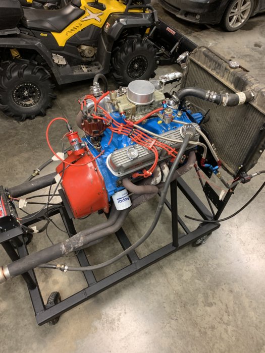

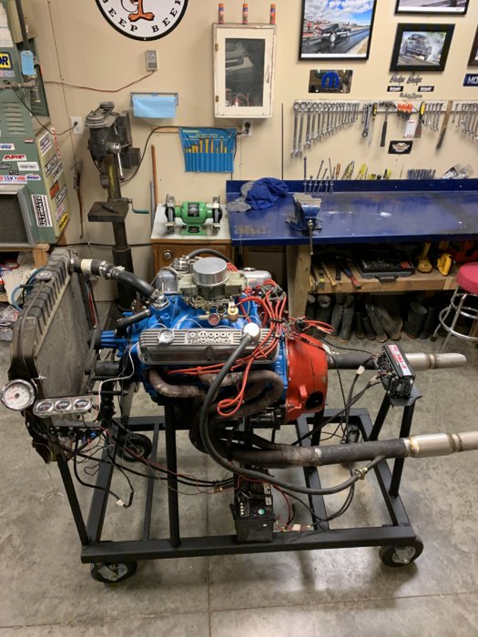

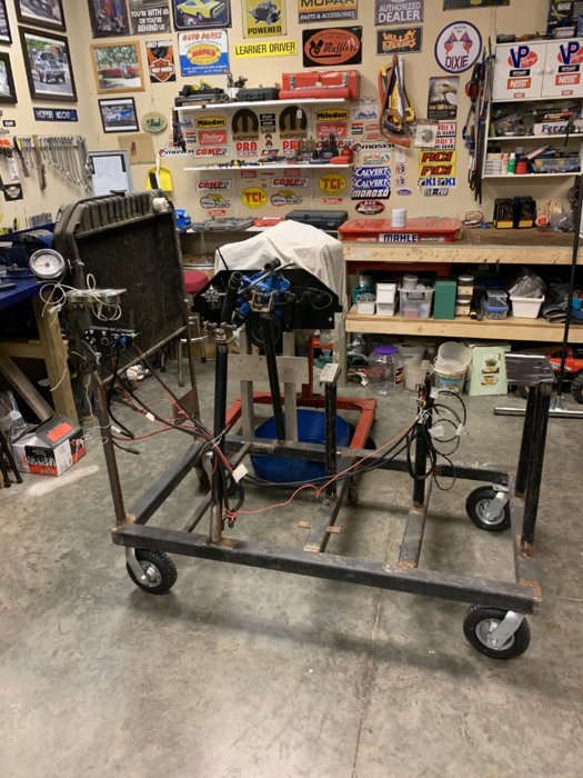

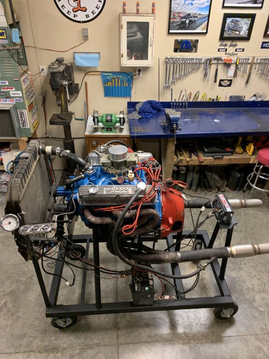

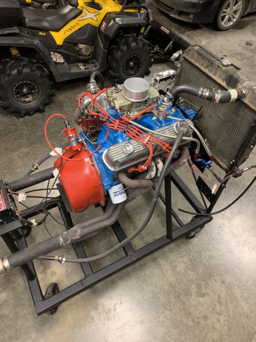

Since the engine is out of car, I will fire it up on engine run stand. Since I had the oil pan off, It will be nice to make sure there is no leaks.
I got to thinking it would also be a good time to change front springs. The front suspension needs a bit more movement. There are a bit stiff. They are 350 and I think I want to try 225-250 springs.

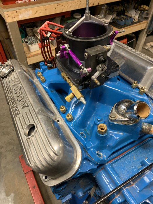

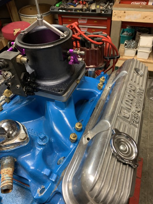

i can't go any bigger on the cam. piston to valve clearance is the limiting factor. i already cut bigger valve pockets in pistons to make this cam work.

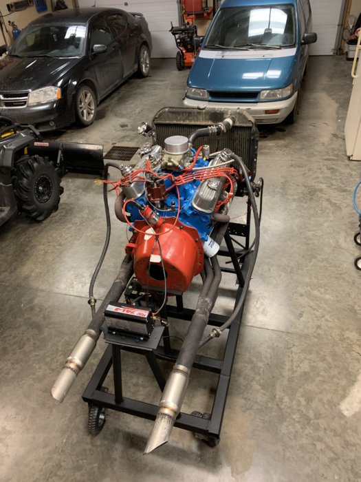

no luck this weekend to fire up engine on run stand. the weather was just to cold. -32*C without the windchill. -41*C with wind.
this week is gonna be colder, -36*C and with windchill, -49*C
