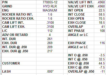

Hi Guys,
I requested the cam card from Howards, lets debate my cam, I dunno what changes but as mine is for a carb engine its been ground on 110LSA.

I am not sure what you guys turn a stock 360 mag engine too, I was thinking 5500rpm is a safe bet, can you go more?
3,171
818
220@.050!!!! Do you want to make torque?
I have a 293/ 289 Ford that makes over 400 tq from 2800 rpm to over 6200 rpm.
Small cubes, big power, let's go for it.
