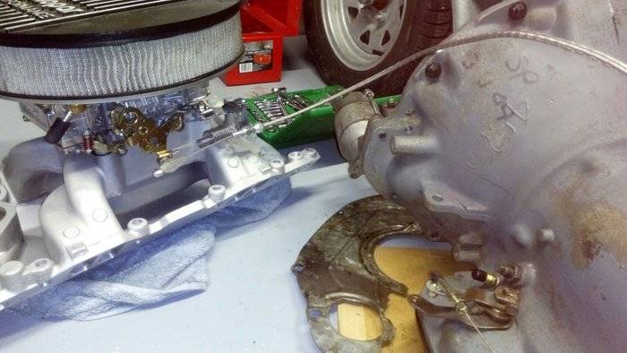

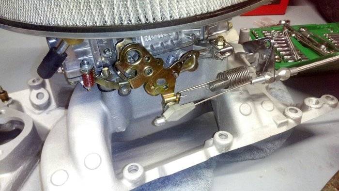

A little bit of progress, this cable system is so nice! Started setting it up on the floor so, I am so impressed I bought the matching throttle cable!

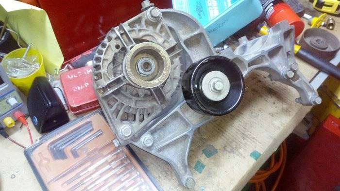

The night before I rebuilt the alternator, fitted new idler, so making little bit of progress.

Looking nice!
Note: for Chryslers, the Throttle cable attachment on carburetor needs to be at an 11:30 O’clock position (closed throttle).
The kickdown cable, if it attaches to bottom of carburetor, will need to be at a 5:30 O’clock position.
Also, the carburetor throttle cable stud will need to be at a 2:30 O-clock position - when carburetor is at WOT (Wide Open Throttle).
GM carburetors (the one shown in picture), the carburetor closed throttle attaches at 10:30 O’clock and is WOT at 1:30 O’clock – which makes a difference on throttle cable length and makes transmission kickdown controls way out of whack.
A Chrysler/Mopar carburetor throttle bracket will fix that (only trying to prevent a problem - before it becomes a problem) - which I think you might have somewhere.

Ok at the moment I have the trans leaver just sitting where you can just feel the pressure come on, then when I opened the throttle fully open the trans leaver is all the way back, I played with the adjustments until I got it working like that. I have then gone to the carb throttle cable in the car and worked out it moves about a tad over an inch from idle to full throttle, I then worked out on the carb by turning throttle and measuring distance it moved and seeing where I needed to be to get full throttle with just over an inch movement, this to me would mean I have it set progressive to the throttle. When the throttle is at 50% the carb will be open half and the leaver will be half way back on the trans. Have I set it up wrong, why do I need a Chrysler carb bracket for the carb when I am not using the rod system anymore?

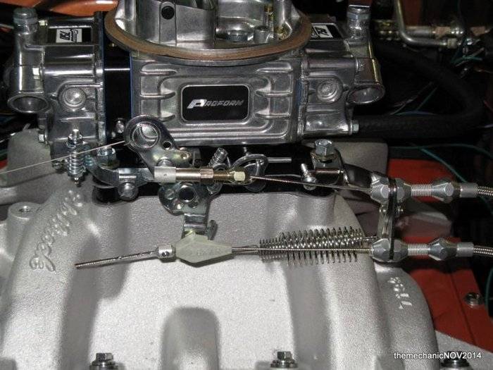

Ok I found this on this site and its pretty much exactly how I was going to set mine up. Scroll to about half way down
lokar cables
1,494
The amount of motion the kickdown rod moves - is greater at beginning of carburetor shaft rotation (off idle) than the amount of motion at the end of shaft rotation (close to WOT) – on the linkage.
This will give transmission less pressure for clutches and less likely to kickdown at part throttle.
Also will make top end kickdown more likely (which might not be a bad thing, for the last part).
Now IF this make much of a difference on a “built up” transmission – probably not.
On a “stock build” transmission – it is a lot bigger of a concern.
On the link you provided – The picture in Post # 16 has the correct setup for Chrysler.

Stops - when the throttle pedal is full down should I be using the carb as the stop or should I be putting a stop under the gas pedal?
1,494
The carburetor should be the WOT stop.
Just make sure there is play in throttle cable wen at idle (in other words, the cable is not holding the throttle open)
