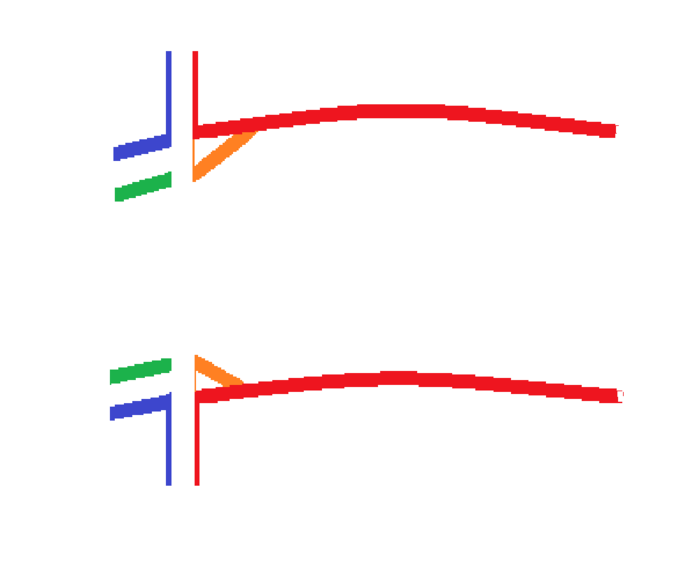

The Performer 2176/3776 is a big port intake that necks down close to the cylinder head to small port cylinder heads. It takes only a few minutes to grind the aluminum ramps off – to make a 360 port intake.
I even ran my 340 with a performer intake for a while (not knowing) and it ran fine before the mod. Sense I don’t like high RPMs, I really didn’t notice the difference - after the ramps were ground off. Also, my 340 had a milder camshaft than what BruceNZ has - which might also be why.
Red is Performer intake.
Blue is 360 cylinder head port. Green is 318 port size.
Orange is the ramp that needs to be ground off for a Performer 2176/3776 to be a true 340/360 port size.
If you see a Performer (not the Performer RPM), stick your finger inside of the port and you will quickly know what I’m talking about. The way it is designed, those ramps grind/sand off pretty quick.
In my opinion, the Performer might be one of the best 340/360 intakes out there - for 90% street usage, that will also work great for a 318.
That said, there are a lot of intakes I hadn't played with . . . yet.
Edit:
BTW, this is not saying that the intake BruceNZ has is not the best one for his application – and it might very well be.
All I’m saying is the Performer 2176/3776 intake was designed to work with both small port (318) heads and 340/360 heads (with minor work).
