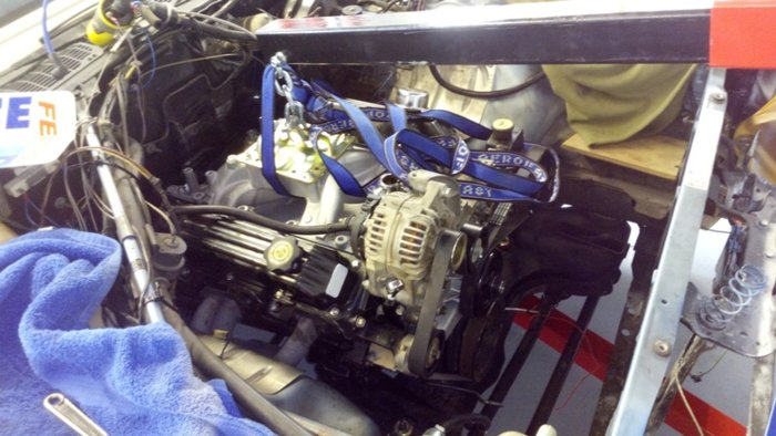

Sat mornings effort

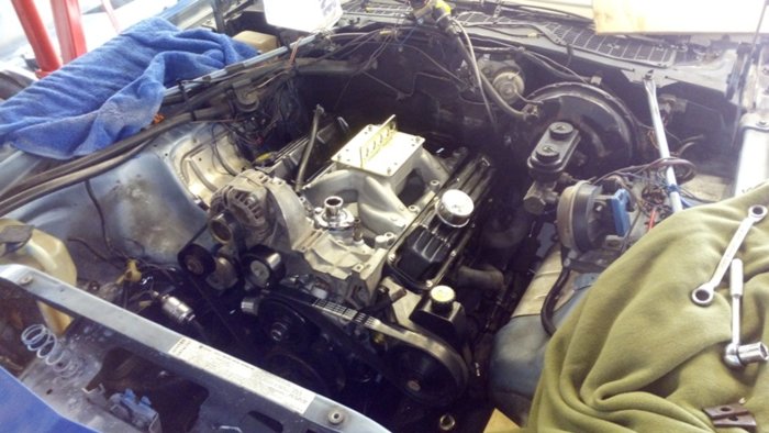

Well I managed to get the trans cross member and engine mounts all done up last night, now onto the dreaded headers! The back bolts are quite a prick to do!

Drivers side header on! the brake booster, the steering column shaft, the steering gear are the problem on the drivers side! But I am probably telling the converted :)

now add in the old style torsion bars and the big old style starter... now thats a pain :)
