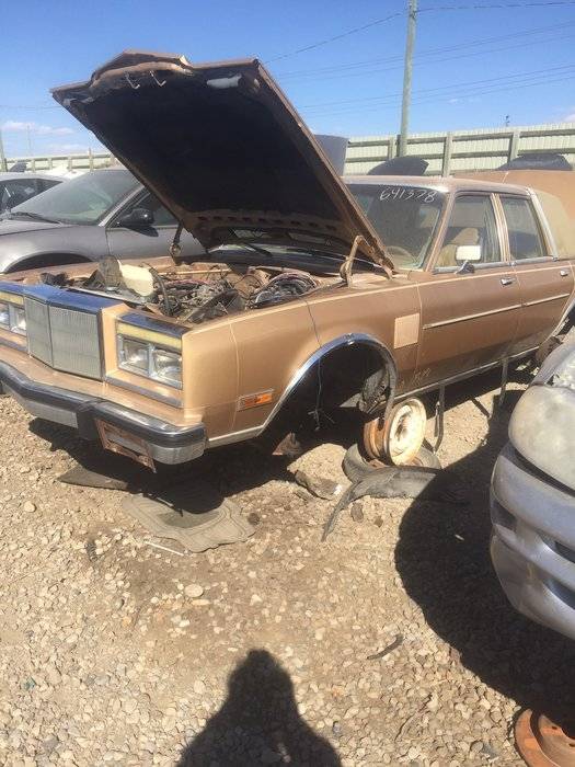

These center rocker panel moldings are on the rockers, below the doors, I take it? Are there any panels on the door (there is an aluminum rocker panel molding on my Cordoba, but that alsoe extends up onto the lower part of the door, but that's a J body, and I don't know the M bodies too well, hence the question)? Do any of the posted pictures of the 5h Aves. help?

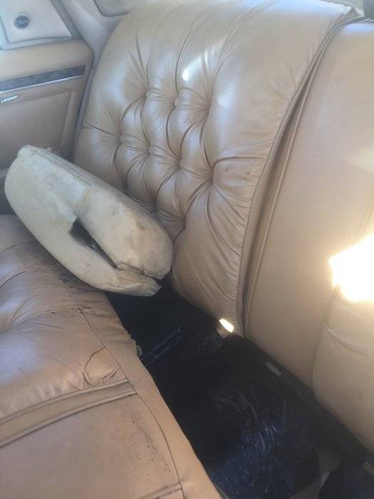

There was actually a 4 door Volare there as well, motor is gone. I also saw a number of 5.9L Magnum V8s, and a 400 big block in a 1975 Newport or New Yorker sedan. Other pickers had taken the carb, distributor, and fan, but the rest of the big block was there. I wish I had the room and money to try and go get that one.

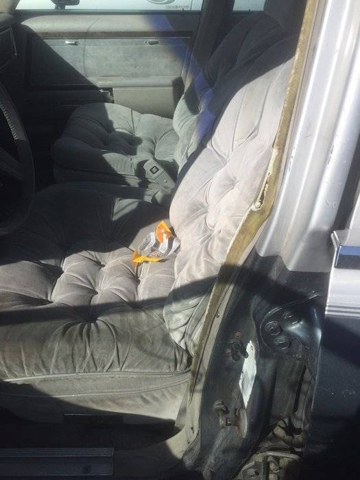

Hard to tell in the pictures, but the seats are VERY sun faded. They look gray in the pictures, but are actually very faded blue ones. They appear to be ripped as well.
Have you considered recovering your seats in fabric? There is a company called SMS (I think) that actually has reproduction fabric that is a really close match to the factory material. You would need two materials, the outer plain dark blue velour, and the center section dark blue and black material. I looked at this for the dark blue 1982 Mirada I had. They even sent samples. If you have a good upholstery shop, or can do the work yourself, it would be new material with the proper colour, without the degraded fabric due to sun and aging.

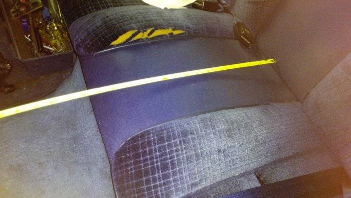

It looks like it might hang a little too far forward, or maybe it just wasn't fitted in fully. This poses a possibility that the rear seat bottom is deeper in the 4 door cars. My rear seat bottom bench measures 20 inches deep at the center of the bench with the tape measure 20 inches out to the visual edge of the front of the seat.
Just off-center where the frame is extended a bit at the rear and the padding adds a bit to the front, in a simple measurement eyeballing it has a maximum depth of about 21.5 inches.
You might take a measurement of your rear seat to see if its much less than 20 inches in depth. It would be good if that were the case, you can just hog-ring the cover at the appropriate length since you're likely to have too much material than too little.
So, this adds to your question about 'bolt in'. The 4 door rear seat bottom may not pass inspection if it doesn't fit right, requiring the transfer of that cover to the 2 door seat frame.
This is one more plus to have the covers removed from the frame before shipping, you'll have to do it possibly for the rear bottom seat if they don't interchange.

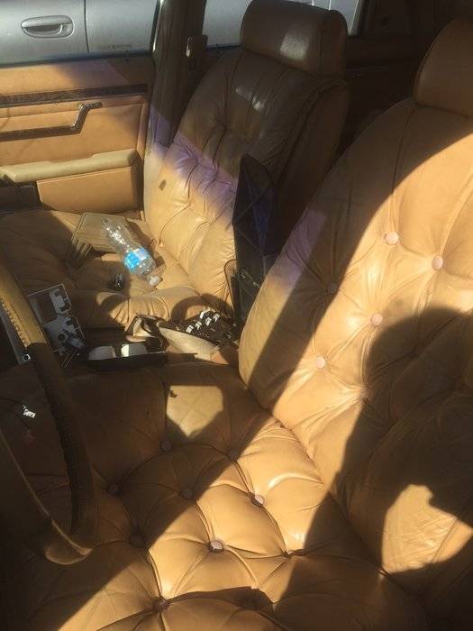

So you found some blue leather seats?
