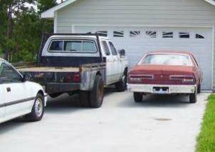

Not exactly hi res but here you go brother...
