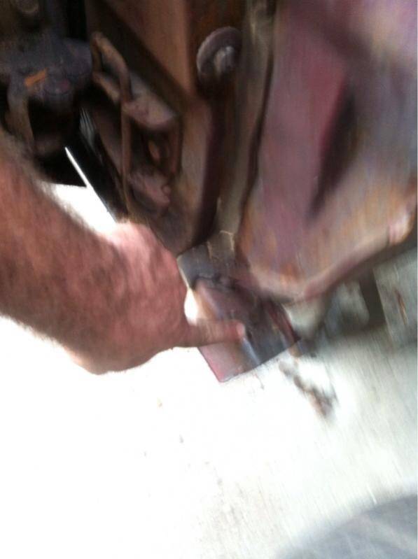

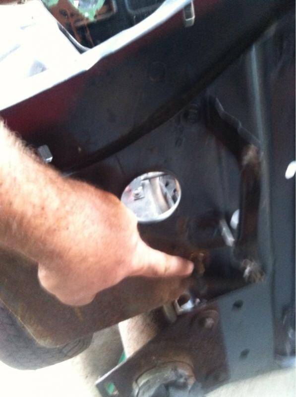

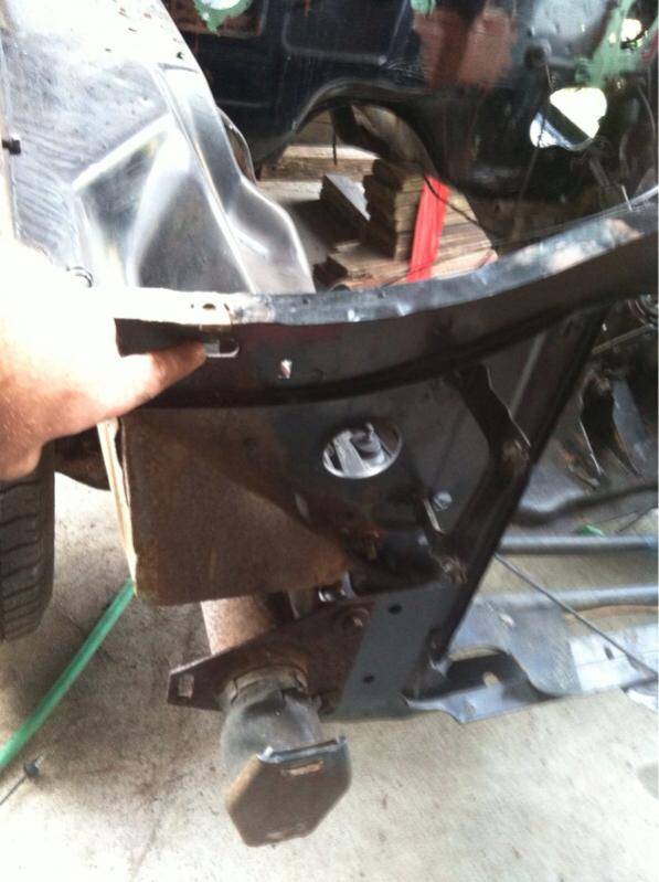

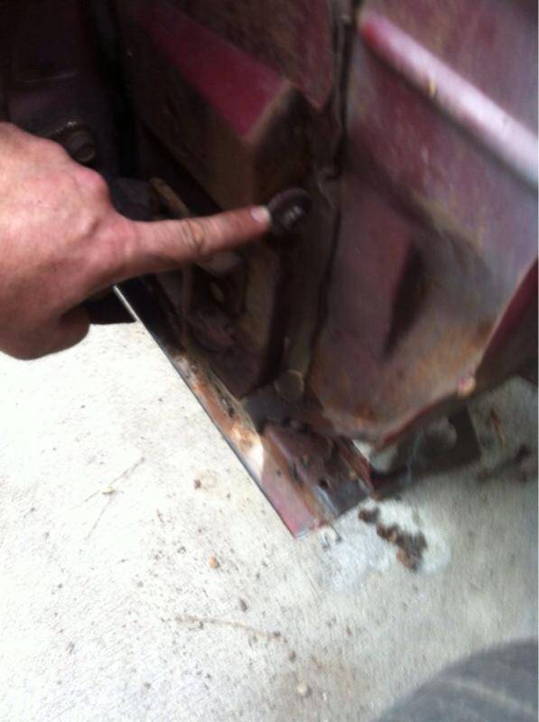

So the last pic of this three is of me pointing to a bolt. It is behind a plastic guard covering the rear of the front wheel well. Inside the cabin is a welded in nut to the body that this particular bolt screws into. Don't do what I did and break off that nut with strength and ignorance. I have done this twice now to parts cars. But I won't forget it.

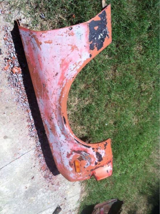

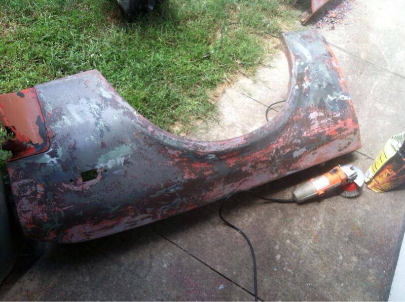

The only thing good about it being so hot, is that the paint stripper (Shop around, $20 a gallon) is faster/more affective with heat. Man does this stuff burn though, I recommend something thicker than box latex gloves. This crap might mess up my love life.

So it would seem that paint stripperin conjunction with a wire wheel is the easiest way to remove 6 different coats of paint & a coat or two of bondo from a fender-Davey Crocket approved!

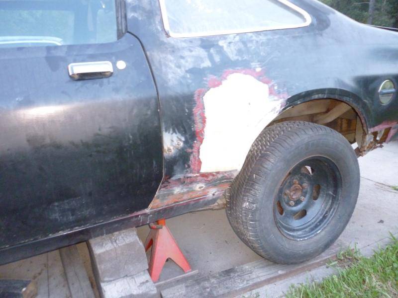

Back to working full time on the hell-raiser. Pulling dents welding holes and body filling.. FUN FUN FUN :tongue3:
Blackbirdsrt78
Jul 29, 2014
792
112
Athens, GA
I should have taken before pics but I will be finishing this up tomorrow and moving onto the next repair. its looking like the metal work for the Hellraiser is going to be about 2 weeks work..

I have wire wheeled and paint stripped the fenders- these are the ones that are the reason there was a recall-
