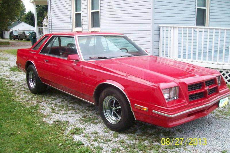

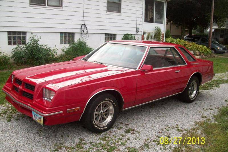

Modoba with drag radials

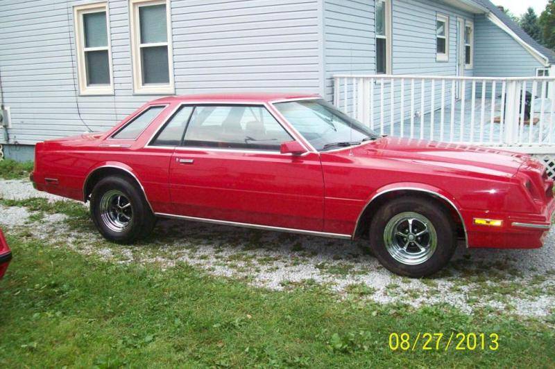

Some pics of Modoba with magnums, drag radials in the rear. Still need to get center caps.I removed the white pinstripe and the body side mouldings. I think it looks better. I still like the 5 on 5 wheels better, but these are my goin' racing set-up. My brother wants them for his cuda, so I may trade for his weld drag lites for racing.
I have road wheels on my '68 and though I'm a fan of the style, I agree the 5 on 5's look better on the Modoba.
I must agree 5 on 5 wheels look great on your car! Im definitely interested in this side molding removal, something that I have thought about doing to mine. It looks a lot better and cleaner without them. So how did you remove them, and was there any holes or apoxy left on the car after removal? Also was there a big difference in the paint under them?
They're held on with a 3m type of tape. Very stubborn stuff. Some of it was hard so I warmed it in the hot sun and used plastic chisel/scrapers to get most of it off, then used a goof-off type solvent to remove the residue. The paint under them doesn't look much different. For the pin-stripe, I tried several things, but the best thing for me was let it sit in the hot sun, then used all my finger nails! Then used the solvent to remove the adhesive. You can still see where the stripes were, as if the glue causes the paint to swell in those areas, but I like it better. I never cared for the pin-stripe. I think the car has such hard lines, that they don't need to be high-lighted. The solvent did flatten the sheen on the paint, so I had to buff those areas again.
Thanks for the info on removing the door spears. Got the driver side done, you were right about the 3m being stubborn!

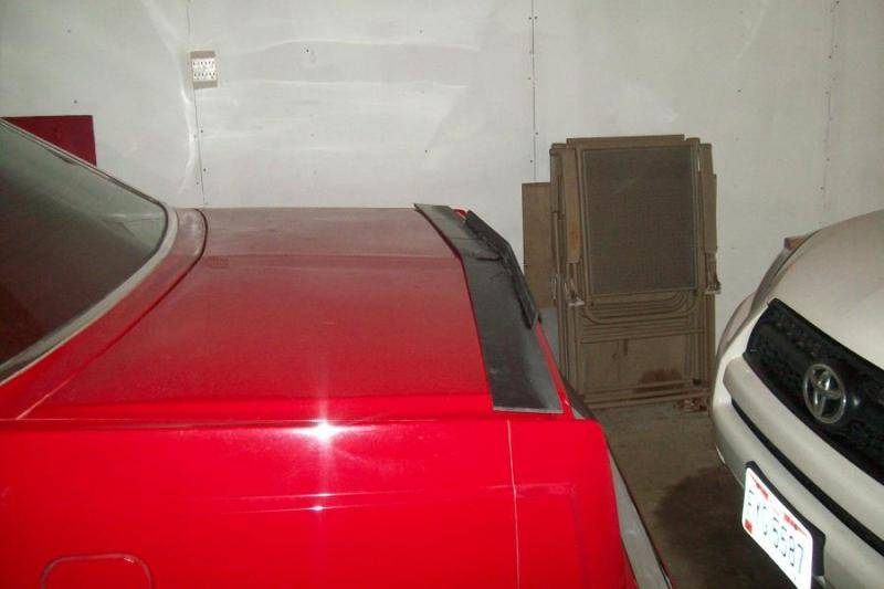

Some of you may remember me talking about making a rear wing for Modoba. After looking at many factory options that all needed mods to fit right, I started from scratch. It will fit the contour of the mirada/cordoba deck lid. It's funny how square these body lines look until you put a straight edge on it! I started making the prototype the other day. It will be subtle with only about a 1.75" lip. The first one I'm making out of .250 abs sheet, and may then do a mold if there is any interest in the design. I'll try to post a pic of the progress tomorrow.

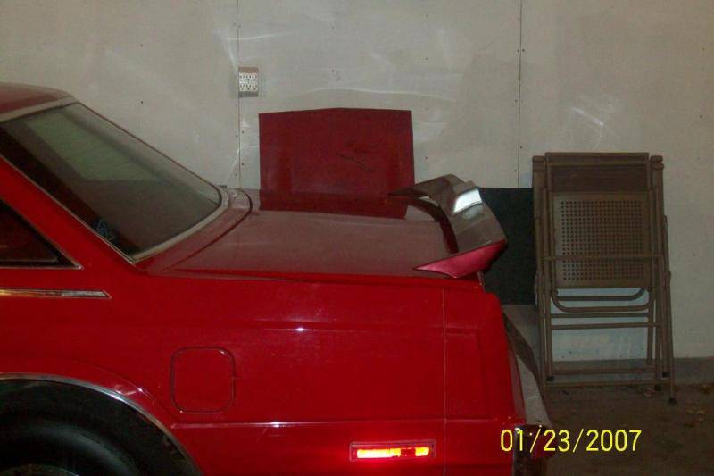

Not much to look at, but you can see the basic shape. It will have a gentle duck tail shape. I didn't have long enough pcs. to do the full length.The second pic is a shelby charger wing that I may still mod to fit, and I think would look very good.

I like the first one myself. If you should decide to make a mold and sell them to others, I would be interested.
