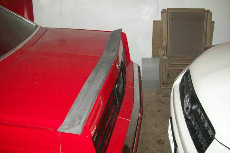

Update on the Cordoba/Mirada wing prototype. You can start to see the profile shaping up.

Hey Adam, I don't mind suggestions, but my car is too high in the rear for my taste anyway. When I had the springs redone last year, it sits about 1.5 " higher than I want. I'll fix that this spring. I Don't like to use air shocks though. On another note, I sold the drag radials and mag. 500's this fall. I just didn't like the look as much as the factory wheels.

This MAY be what I am looking for in a rear spoiler. I can't tell yet, but looking forward to seeing the completed project. Otherwise, I'm probably going to end up buying the late model Challenger spoiler and making it work.

Not much to look at, but you can see the basic shape. It will have a gentle duck tail shape. I didn't have long enough pcs. to do the full length.The second pic is a shelby charger wing that I may still mod to fit, and I think would look very good.
Pick it up & rotate it so that ends & third brake light are touching the deck lid. I know the mounts would be visible, but the profile might look cool, similar to a 3000 GT VR-4. I'm sure it'd need mod.'d, but might be interesting.

I have challenger wing also. It has a little to much radius as is and would have to be cut in half and the angle changed. It is a nice style though. Who knows, I may hack it up too!

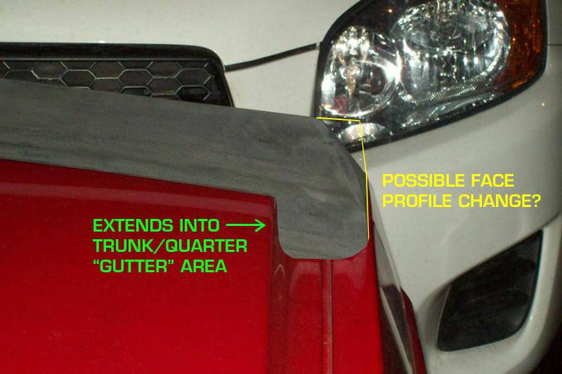

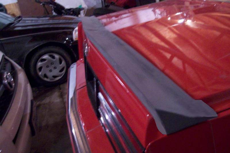

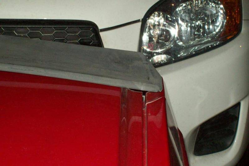

Prototype wing getting closer. I like the idea of the wing extending to the top of the 1/4 panel, but I'm just not sure about the space under the end because of the shape of the deck lid. Should this type of wing end on the raised part of the deck lid? Maybe only a pedestal wing looks right going to the 1/4's? Thoughts?

I think it would look great if you contoured the bottom edge of the spoiler to follow the depression in the edge of the trunklid & quarter panel. For it to look right, the front surface would have to extend forward & down at the same time into the "gutter" between the trunk lid & quarter, while the tail side would dip down accordingly. You'd probably want to reprofile the outer vertical flats & corners so it looks more "geometrically correct" with the gutter extensions. The front edge of the spoiler really needs to come to a point, though, rather than that flat edge you currently have.
What the heck am I talking about? I apologize for the shoddy Photoshop work, but it'll do for a few minutes' work to help you visualize what I mean.
Obviously, much like 1-piece spoilers used on other makes or models that overlap the trunk joint, you'd want to leave "slam clearance" between the bottom edge of the spoiler extensions I added; it would only be attached where you've currently got it laid out. That's how it was done on the ducktail spoilers used on the AAR/TA cars and the F-body 1-piece spoilers.

That's kind of like a pattern I did a year and a half ago, and I think you may be right, it kind of works like that. I thought about that profile on the edge also. I used the late challenger wing as the basic design for mine...same thickness on front edge, but I do think thinner would be better. We'll see where it goes from here.

NoCar's rendition would look good, but I'd also consider just ending it at the edge of the trunk, like the NASCAR Magnums were. See Buddy Arrington's Magnum for example. There is some '80s street car that has a factory spoiler like that too, but for the life of me, I can't think of what it is right now. It isn't the Monte Carlo or Grand National, but some other car that has a shape similar to a J-body.
