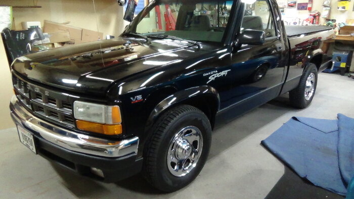

Just remembered, the N-body ('96 Dakota) turns 25 this coming August 15th. Another one of those where does the time go things. It was barely 2 years old when I bought it in '98 with 48,000 miles. Now at 170,000, still going strong. Yes, it's had some cosmetic surgery, quite extensive cosmetic surgery to repair some severe cancer but the mechanicals and interior are pretty much untouched aside from regular maintenance. Runs perfect, uses MAYBE a quart of oil in 3,000 miles, everything works, interior is still nice and most important, it was paid for 20 years ago, lol. Actually, it's the only vehicle I've ever owned that I took out a loan to buy.:)
