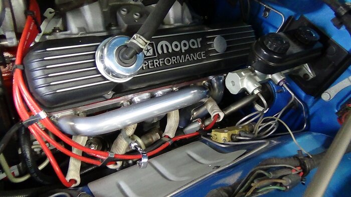

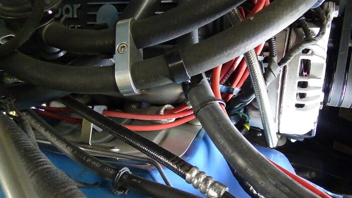

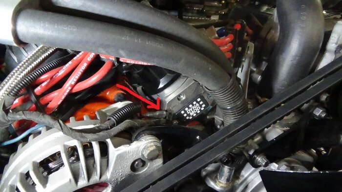

Then all I need to do is change the plugs. Driver's side, not a big deal. Passenger side,,,,,,,,,,,well,,,,,,,,,,,a picture is worth a thousand words.:D The biggest trick is getting the passenger side access panel off without scratching anything. It must come off or no spark plugs, lol.

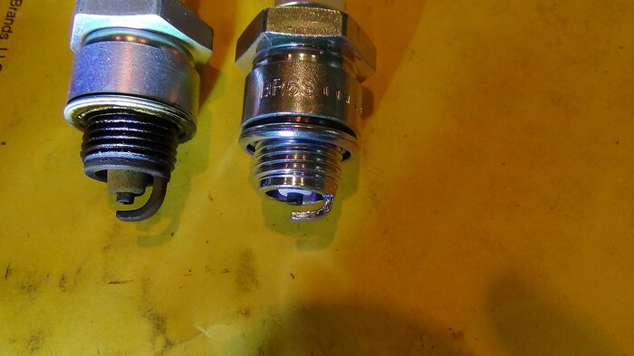

Changed the plugs and hope they work because I'm never changing the passenger side plugs ever again.:D I must be getting old:confused:
There's a visible difference between the old and new as far as the insulator length. If there weren't clouds topping at 40,000 and rumbles of thunder in the distance, I'd take the car out for a ride and also fill up with fresh gas. It'll have to wait.:(
