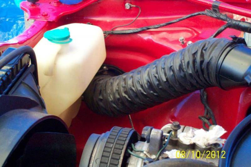

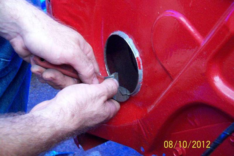

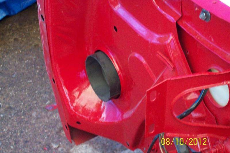

I finished the passinger side cold air intake. I couldn't find a tool to cut the hole and put a flare on it, so I used a hole saw and a small cresent wrench to gently work in the flare. It took about 5 trips around the perimeter of the hole, but I'm happy with the results.

Wow....thats a huge improvement, it didn't look bad before... but now....WOW!

No time like the present. Scrub it down good with with a scotchbright pad and wipe down with clean lint free cloth and appropriate reducer/thinner, wipe again with tack cloth and paint. You will thank yourself later! IMHO

I still can't beleive that's the same car I saw just a few months ago. You've done an amazing job and impressed the daylights out of me.

I like the custom flare work! You've got me thinking about a cold-air intake for the truck. Your's looks great!

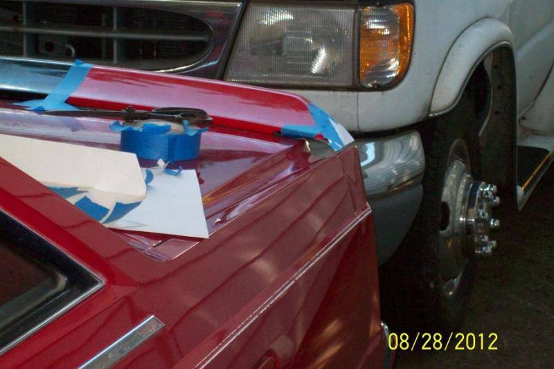

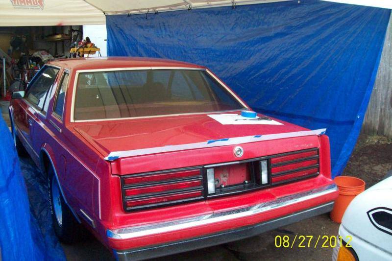

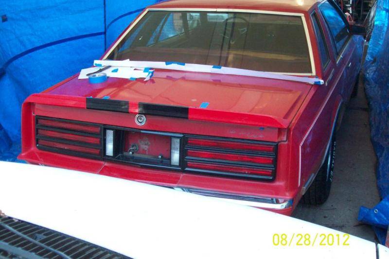

I had back surgery last thursday and won't be able to do much, but I had an idea. This may be the pain killers at work .... so I'll get your thoughts. I was thinking of fabbing a subtle, nascar-ish rear wing in stainless or aluminum. I did a quick and dirty mock-up in poster board.

That might look pretty cool,body color?black?Those pain killers has your mind going in the right direction.Car looks great.

I like it too...go for it. Take care of your back!
X4 I like the spoiler idea. And be extremely careful with your back. I had back surgery 20 years ago and ruptured the same disc recently.

make two I'll buy the second one I've been thinking the same thing for a long time I think the spoiler adds the right amount of panage to the back of the car good work

Here is another look with a late model challenger wing with slight mods to better fit the body. what do you think?

Not bad at all. I say go for it. I've got a trans am wing for mine. Those look pretty good if you can get over putting a GM part on your Mopar.

I had one of those t/a wings on the 440 mirada years ago. They do look and fit good, but want to maybe try somthing different. The bigger fiero wing works also but may be too big for my taste.
